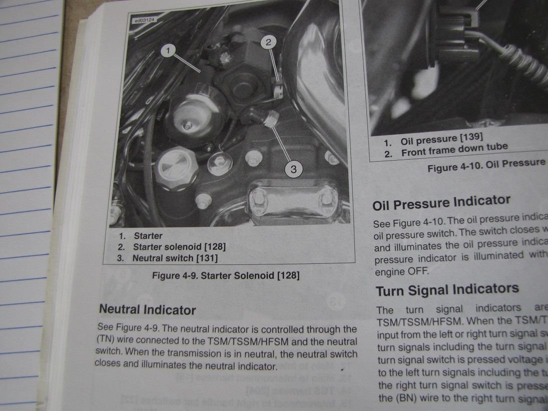

My neutral indicator is not coming on in neutral. I'll be checking the switch on top of the transmission this evening. The other thing I think it could be is a ground somewhere. Does anyone have any info on where to look to resolve this if the switch is good? Thanks in advance.

Get some small needle nose pliers and squeeze the metal inside the two wires at he switch. It is usually a bad connection there to the two posts of the switch.

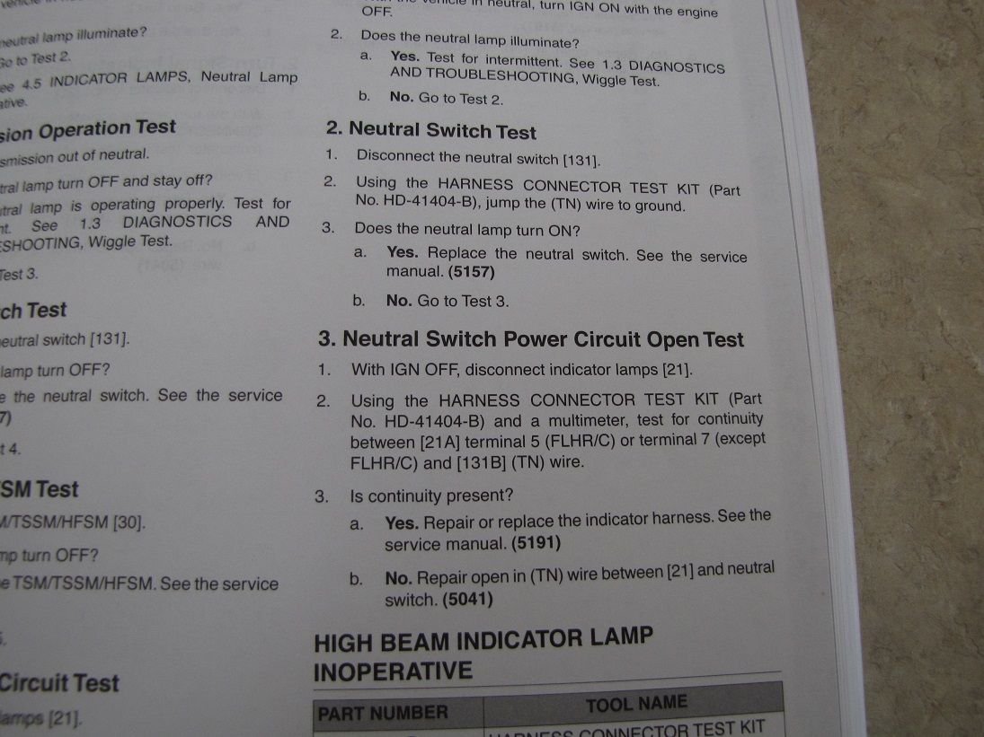

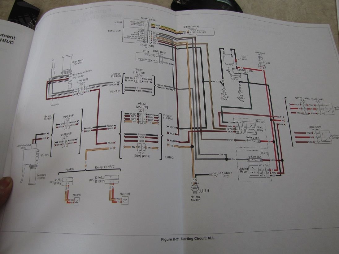

It wasn't the switch... anyone have a guess about where the ground for that circuit might be?

Part of the time it will and part of the time it won't. The neutral light does not come on when I bypass the switch and turn the ign on.

Check the two wires going to the plug. The one that is not black should have 12 volts. If that is good run that wire to ground and check the light. If there is no 12 volts, start checking back along that wire for a break or a plug not fully seated or a corroded connection.
