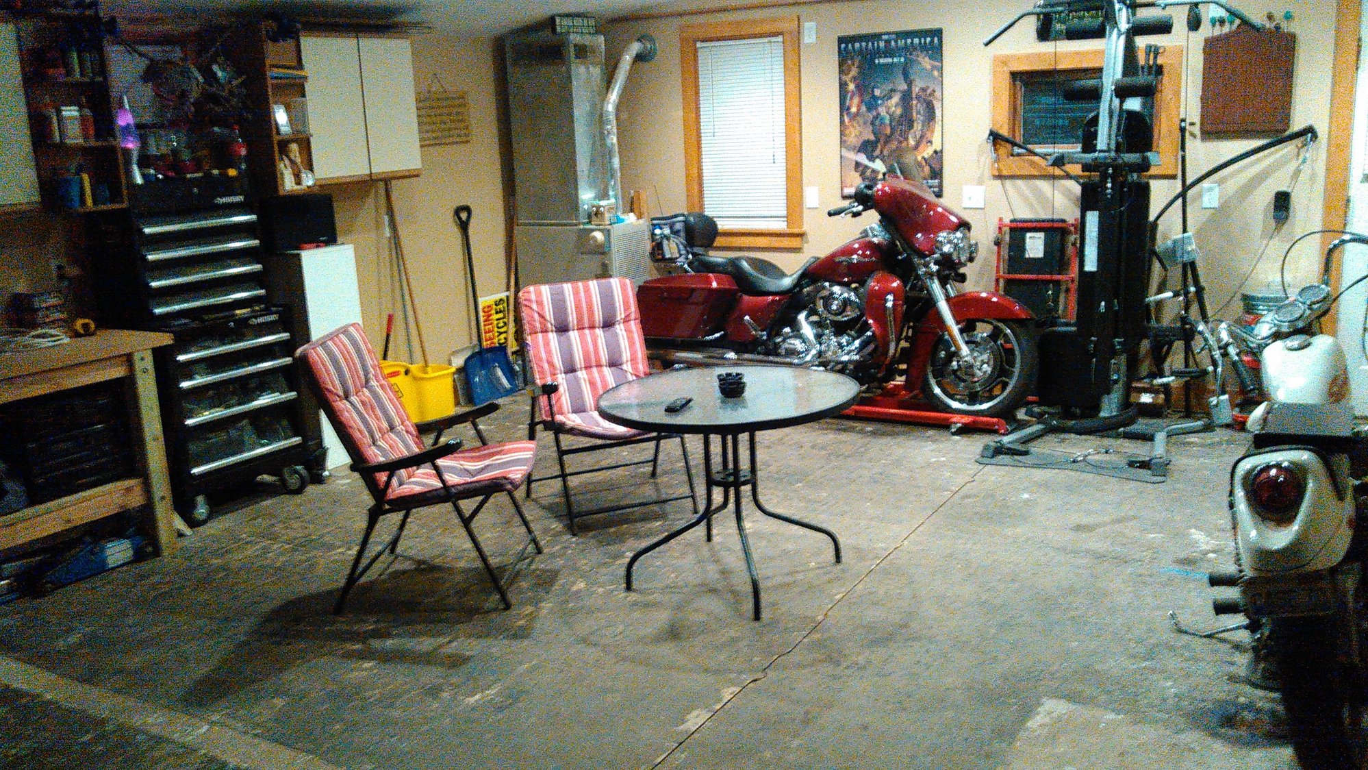

i got a hf dolly for less than 80.00 delivered.. think it was like 89 on sale and then used the 20percent off coupon and with a delivery fee of 6.99 it was under 80.. closer to 75 i think.. i could find the confirmation email if i had to.. for the 6.99 i couldn't afford to drive to the store...was surprised it took the coupon online and gave the sale price. it even said on the item description that some kinda of large item extra charge applied but i wasn't charged it...
my 2010 streetglide fits fine on it and it works well...
didn't have to move the side stand at all on mine.. was in a good spot.
notice the stand? it can be centered but i roll bike back and leave it in gear so i can roll it around without worrying about it coming off stand.. as i don't use the stops... <br/>
works well to push in between furnace and other stuff<br/>
rolled bike back and left in gear so stand caught dolly and i can pull it around without worry about it rolling off as i don't use the stops..

I use the harbor freight dolly also. But one thing I did differently was I drilled two new holes for the side stand part. Its best to have the jiffy stand in the middle of the stand part. I had it on the end like the above pictures and when I would push the bike around in the garage. I would notice the stand area flex.

the bike stand is center on the dolly until i roll it back and put it in gear... i use the stand to ensure the bike doesn't move on the dolly when i pull the bike around. if i drilled new holes and moved the stand plate it wouldn't be in the "center range" of the stand.
