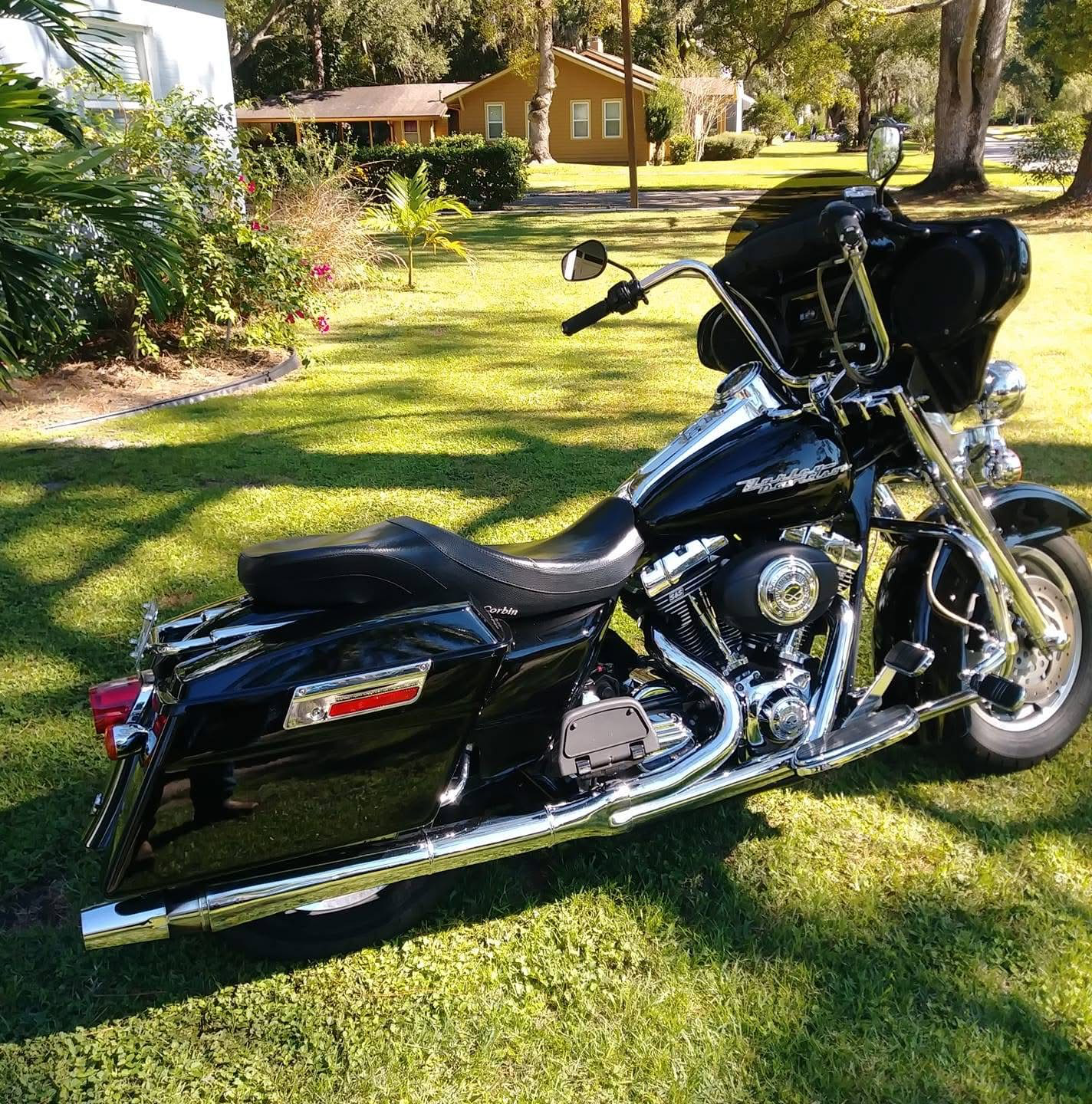

Default 04 road king fuel injected 80,000 miles no cam chain tensioner issues went gear to gear , punched out to a 95 cubic inch motor, weisco pistons, s&s cams s&s heads , power vision dynotuned, get , thunder header, exhaust , 150,000 mile motor e

04 Road king bought 10 yrs ago w/ 5,000miles on it , currently has 80,000 miles
twin cam 88 motors run lean from the factory (government emissions) the first thing I did at 40,000 miles was
Get that garbage Harley map out of there
, went gear to gear , no more cam chain to deal with , s&s cams, weisco flat top pistons , punched out to 95 cubic inch motor power vision tuned 2 into one exhaust and a set of s&s heads
