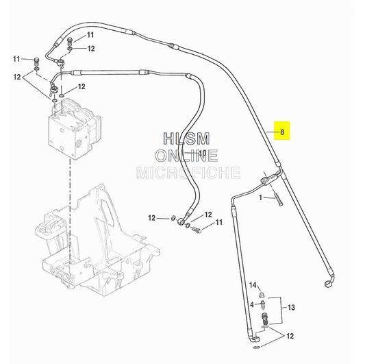

That wouldn't appear to correspond to this illustration
But this would
