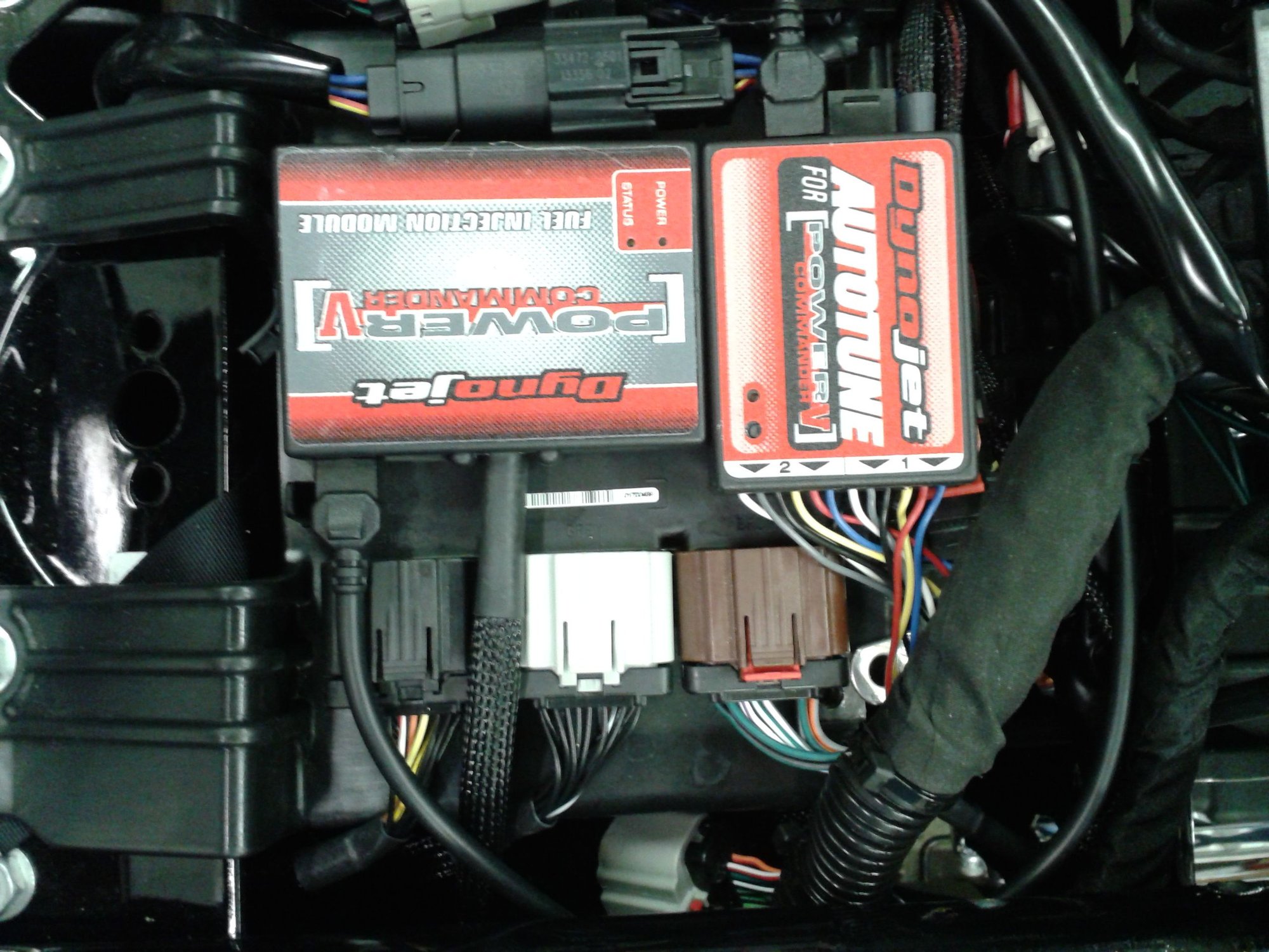

I decided to replace the headers with V&H True Duals and keep the Rineharts. That setup was okay but and I seemed to have some improved performance but I didn't think the tune was right. I decided to put a Power Commander on it, purchased from Fuel Moto and their standard map for my setup. Bike still didn't run like I thought it should (or could). So I then put an Autotune unit on it.
Adding this unit was a real PITA with the V&H Headers. The 02 Sensor for the rear cylinder is positioned so that it was extremely difficult to get it mounted. It is pinned up against the tranny cover and I ended up cross threading the vent port and although it was a very frustrating install, I finally got it mounted and even though I had concerns that the sensor wires were pinned right up against the cover and I thought they might be pinched to the point of where they would not function properly, it seemed I was getting good readings from the sensor.

The pre-ignition is almost certainly the tune, combined with carbon build-up on the pistons, courtesy of the EPA.
We see it every week, carbon build-up in the combustion chamber makes the engine run worse, when nothing else has changed.
Get an External Breather System, blow out the carbon in your cylinders, that will take care of part of your problem.
Pictures showing why I wrote the above-
Sometimes Rineharts can be difficult Slip-ons to get a good tune out of. Easy fix is to install some Thunder Torque Inserts. This will increase your low and mid range power (get it running more like you thought it should) and will decrease/eliminate the decel pop....also make your auto-tune work better.
The above, combined, are less than $100, but I think you will end up with a better result than spending upwards of $1000 on a new exhaust system.
If you are set on getting a new exhaust system, I would look at the Fuelmoto 2-1-2 headers, or the V&H Power Duals. Both are great pipes.
Whatever you do, I would install an EBS, and almost every slip-on will produce more power with the TTI's.
