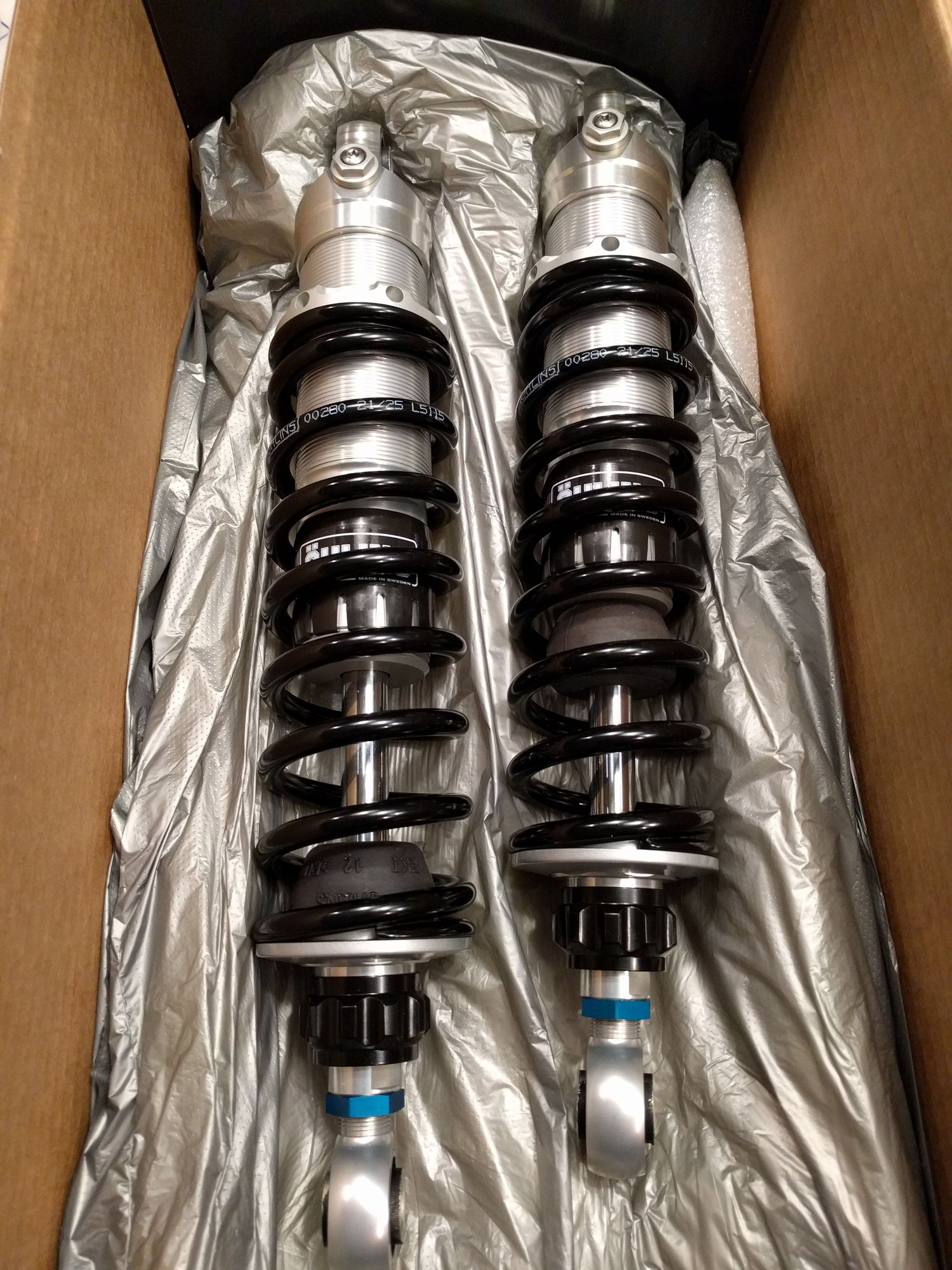

I just received my Ohlins. Have to work all weekend, they will be attached next week. Thanks Howard

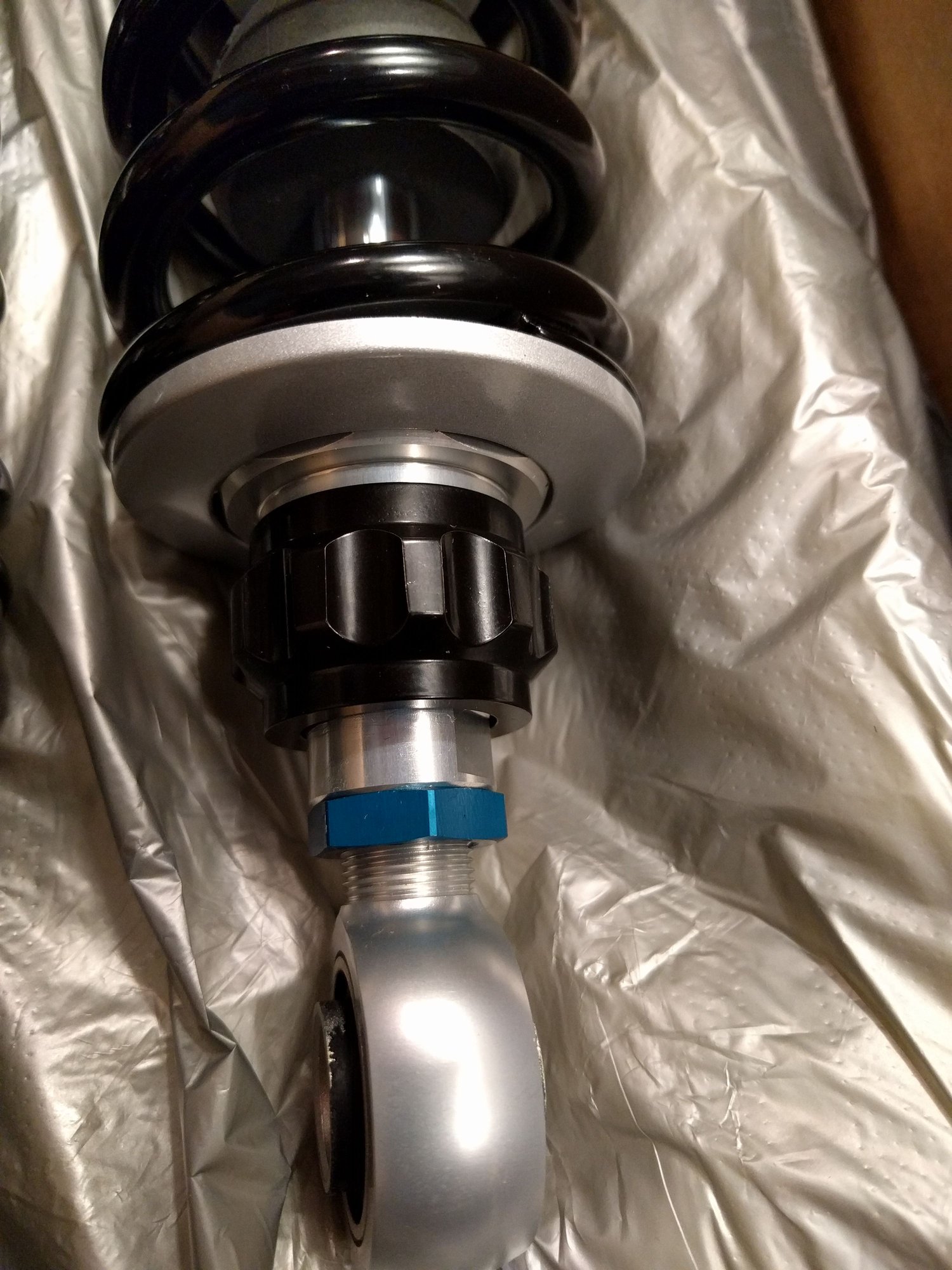

What version are those? Shock length and advertised travel amount? I ask because of all the hardware on the bottom of shock - blue nut, adjuster with extended threaded shaft and black ****. It seems all that hardware replaces valuable suspension travel. The amount of shock shaft showing + bump stop is "actual shock travel" and it could be more without all that hardware. It looks like the lower hardware allows the shock to be adjusted to different lengths. ie 12" ~ 13" shock. But at the cost of suspension travel.
S36E shock.
They look like Ohlins HD-159's.
Length: 329 +5/-5 mm
Stroke: 77 mm
Spring length: 200 mm
Spring rate: 25 N/mm
Spring: 00280-21
Diameter of spring: 46 mm
Stroke: 77 mm
Spring: 00280-21
13" with 3'" of travel then. They move the travel up as these have rebound damping. Makes sense now.
S36E shock.
It is the internal floating piston on the divided chamber shocks that take up space that reduces travel. My 13.25" s36e Ohlins have over 4" of shock travel
