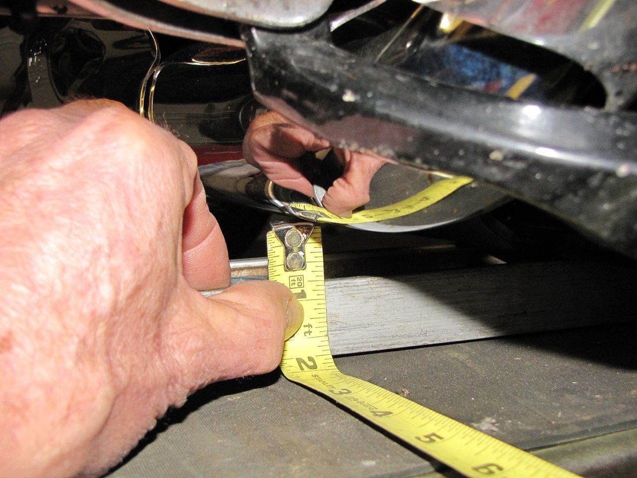

Look familiar? shocks help but the problem is the **** poor designed header. I just went with a Fuel moto header and the stock shields.

I put my bike on the lift and laid a level on a scissor jack and raised it so it touched on both sides of the frame then measured up to the heat shield and had 3/4". Neither one of us has marks on our heat shields, but then we don't ride like you do.
I know it's your bike and you'll ride it like you want to but step back for a minute and realize the consequences if you over do it.
I am not real sure where you are going with this. The problem exists with the bike leaned over so the measurement would be in degree's from the contact patch of the tire and bottom of the header. It is majorly amplified by the stock suspension compressing too much without recovering. There are more than one person reporting issues.
I hear what you are saying about pushing it but some times on unfamiliar corners with dips and bumps in them I would rather not introduce a potential problem. The floor boards are hinged to give you a warning shot and they should touch before the pipes or frame.
