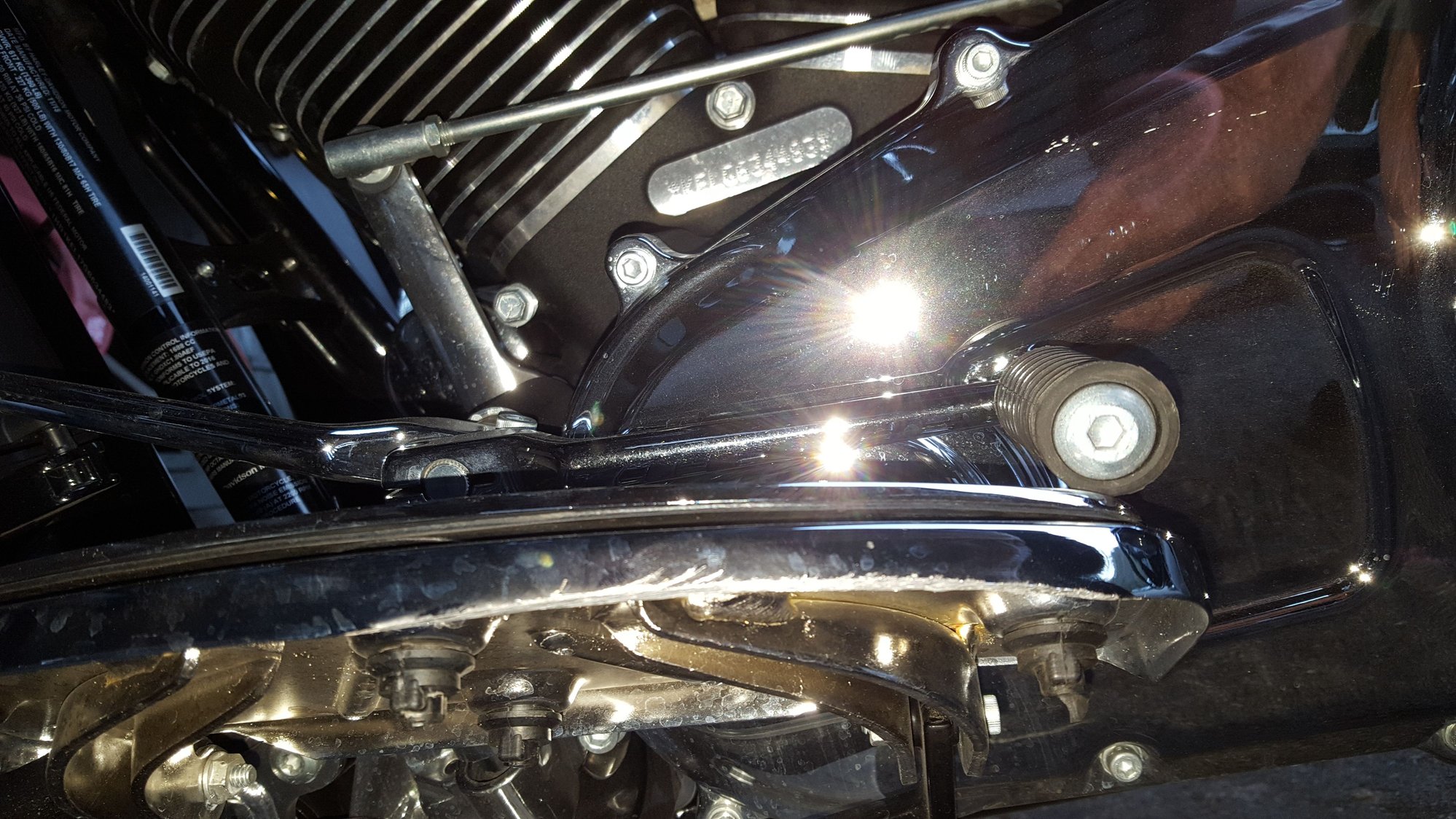

I installed RC Components Power Max pipes a couple thousand miles ago and have yet to scrape them. They have the true dual look but still have a baffled crossover chamber as well.

So I "built" my 16 Limited. You can see the details in my sig. It runs great. The HD shop told me I'd get the BEST HP/TQ out of a 2 in to 1. I don't like that look, and wasn't worth the added 3HP/TQ or whatever. I went with 2-1-2 V&H Power Duals. I like the look ok, but the header look, or that V&H heat shield isn't that big a deal. The real issue is they severely reduce lean angle on the right side. I don't mind them scratched up from cornering, but the difference from the right side to the left is noticeable. Moreover, when you get down on a floorboard, it gives...the header doesn't give so much. On roads that are not as smooth it hits hard at times. I'm afraid it's eventually going to leverage the back tire enough to induce a low side fall. Suggestions on another 2.1.2 brand of header that won't hang so low? Is there one?
I just finished a long weekend in the Western NC, E. Tenn. and N. Georgia mountains. 1400 miles plus. The bike came home with 2700 plus miles on it. The header heat shield already looks like what you see below. I guess I'll be replacing the heat shield soon unless I find an alternative header system.
My Dresser Duals have scrap marks too. Be prepared for sticker shock just for heat shields from V&H. Might as well buy new pipes.
