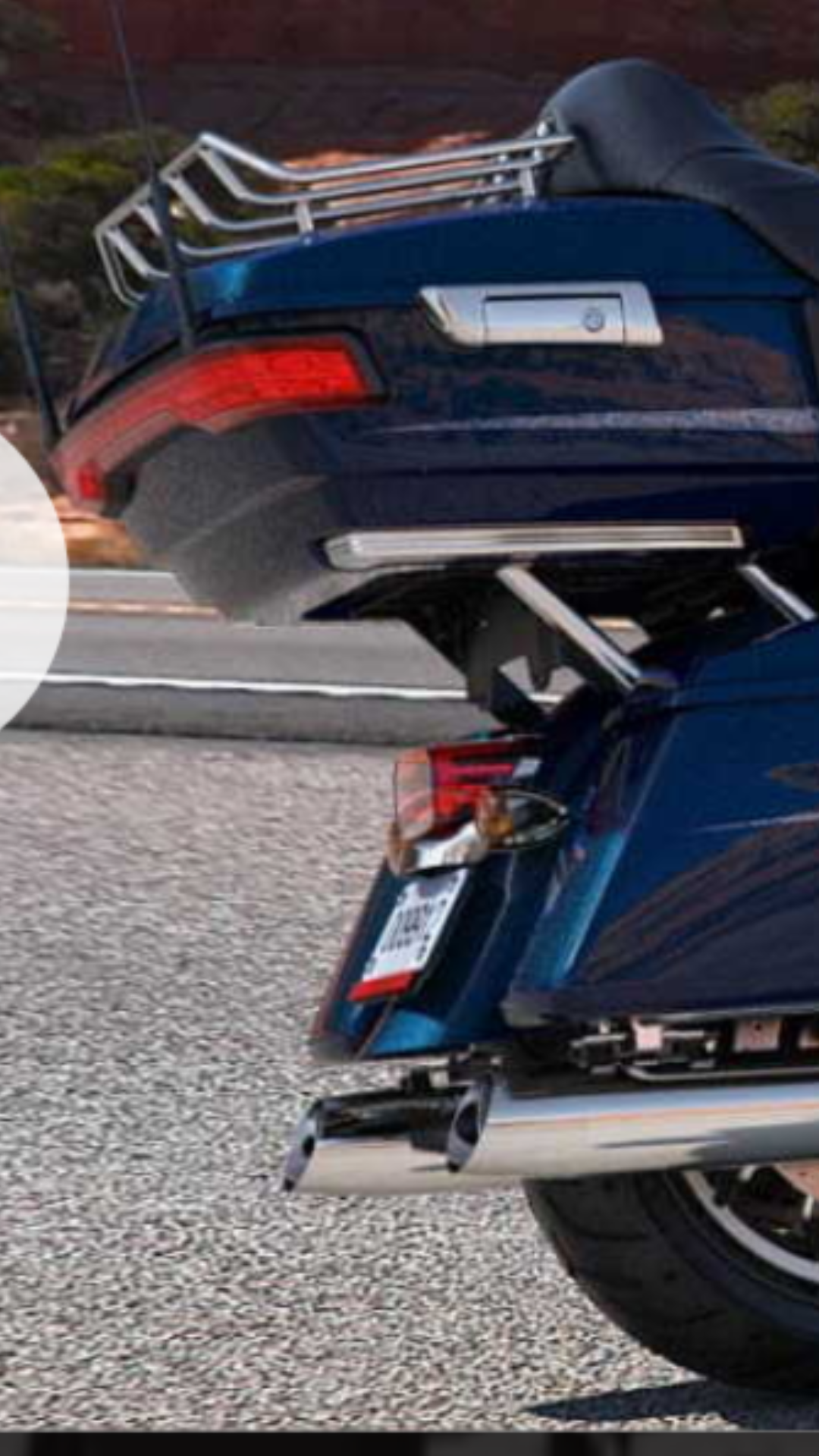

Tried to link Ronnies HD parts finder.
What you need for the rear is a foreign 2014 Ultra Limited light bar. The number I gave you was wrong.
