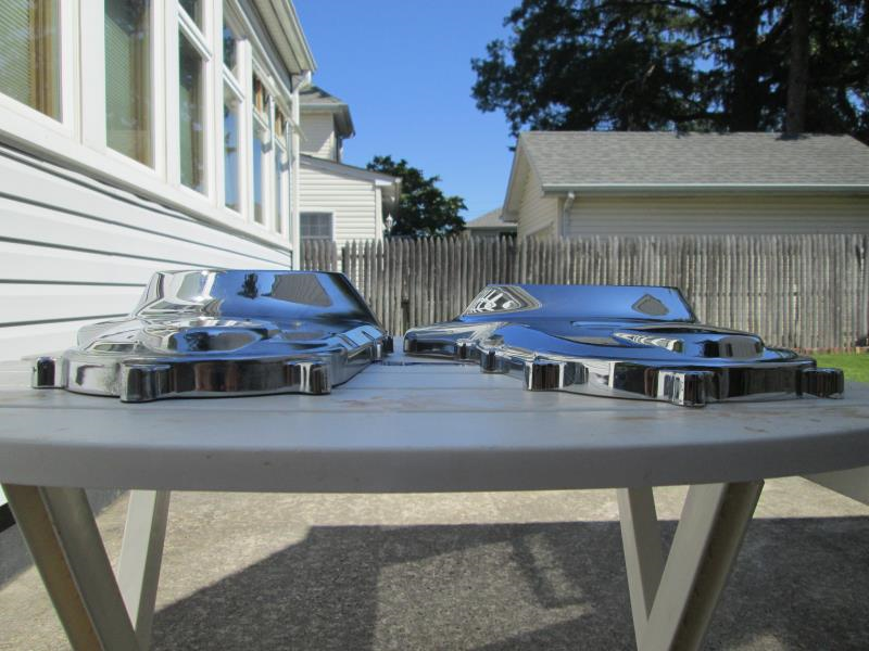

Remember you will be doing a dry fill the first time. The narrow primary is a 34 oz wet fill. Filled with bike straight up. The larger cover is the reason.
If I replace my narrow cover with a standard cover on my 16 limited , is it still 34 ounces?
Thanks
Thanks
I doubt it. Simply fill to the correct level as per your owners manual, on the clutch pressure plate, as per the diagram at post #22 above.
