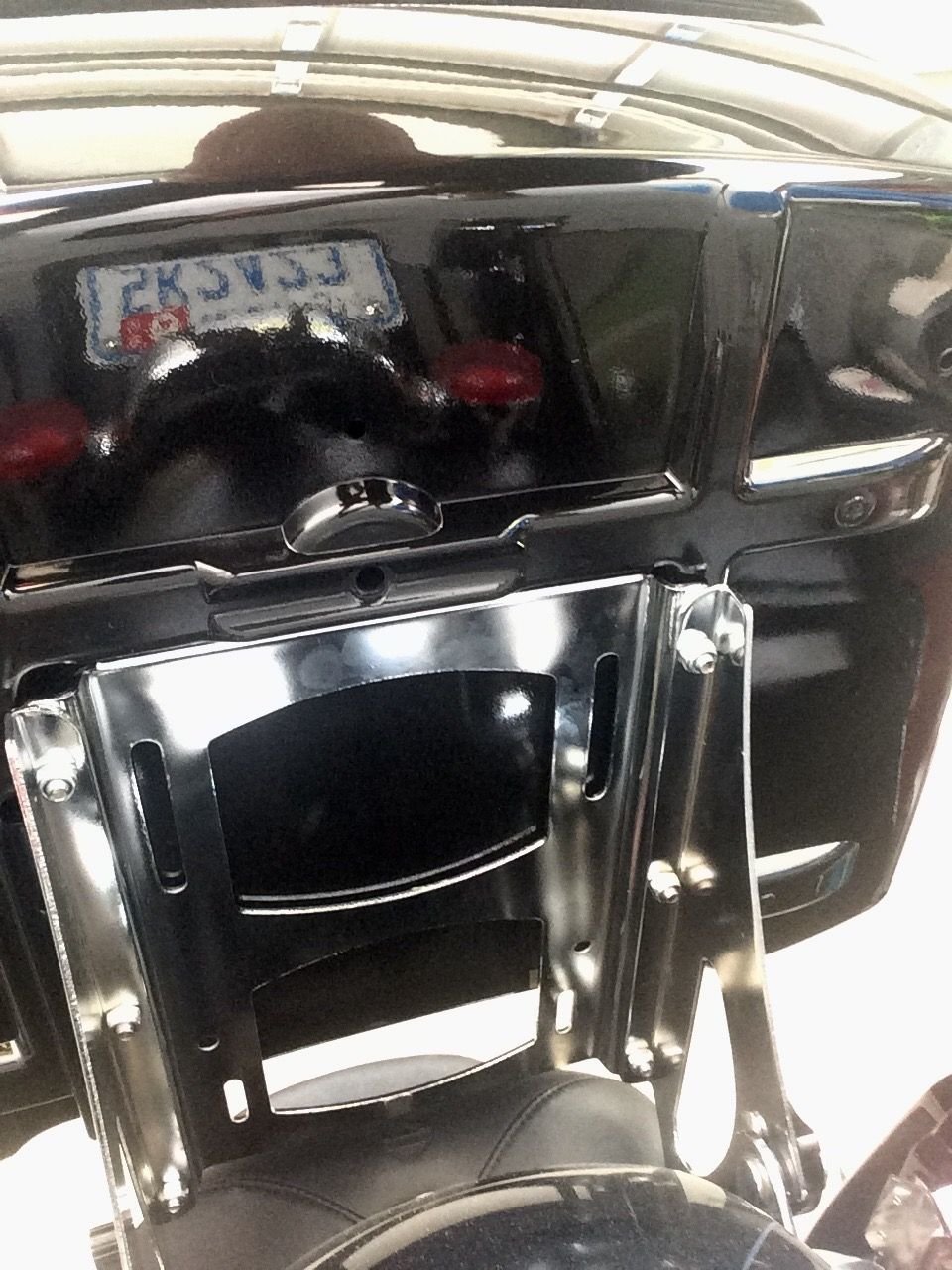

Mounted it with a metal plate, this allows you to attach the TP to the detach rack anywhere you like. I used 5 bolts for TP, and 4/5 for plate to rack. 1 bolt in center of TP also goes through center of plate. 4 more bolts to attach plate to detach rack. 4 other bolts to mount TP to plate. The TP is wider then the detach mount. The wider plate provides more TP stability imo. Added some rubber hose split in half on the outboard sides of the TP where it sits on the plate to make contact everywhere. The ends on this TP curve up a bit and are not level with the TP bolt holes mounting locations.
