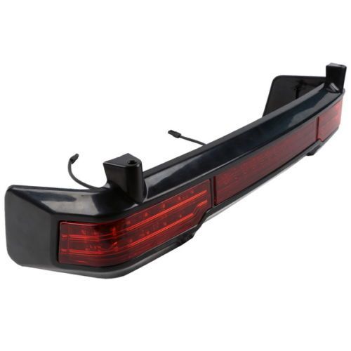

I have an 11 FLHTK with LED Tail Brake Running Light, and i think its an after market one. The one Harley has is connected into tail light but this one has a module between tail ligth. Issue is that lost running corner lights, just center left. Brake light on all Three. Is it something possible to repair or change?

It is difficult to guess what the repair is...
some run/brake/tail module type devices use 5 or 6 volts for run light function and increase the voltage to 12 volts for brake light ( my H-D RTB module does this)
I would guess that the parts are very expensive there- you should try to find a technician who has a background in electronics and can test the leds and determine just what the module is supposed to be doing.

Is there any branding on the side we can't see in your photo?! May give us a clue or two to help get to the bottom of this.
