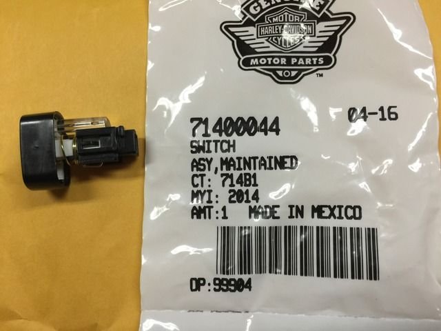

For the ~15 bucks, I'd install a new switch and be done with it.

Is the bike still under warranty? If so, HD should fix it for you. If not just replace the switch. There are no recalls on that switch- you can look up any recalls applicable to your bike on HD's website. As shown above, new switch is cheap so if no warranty, just put in a new one.
