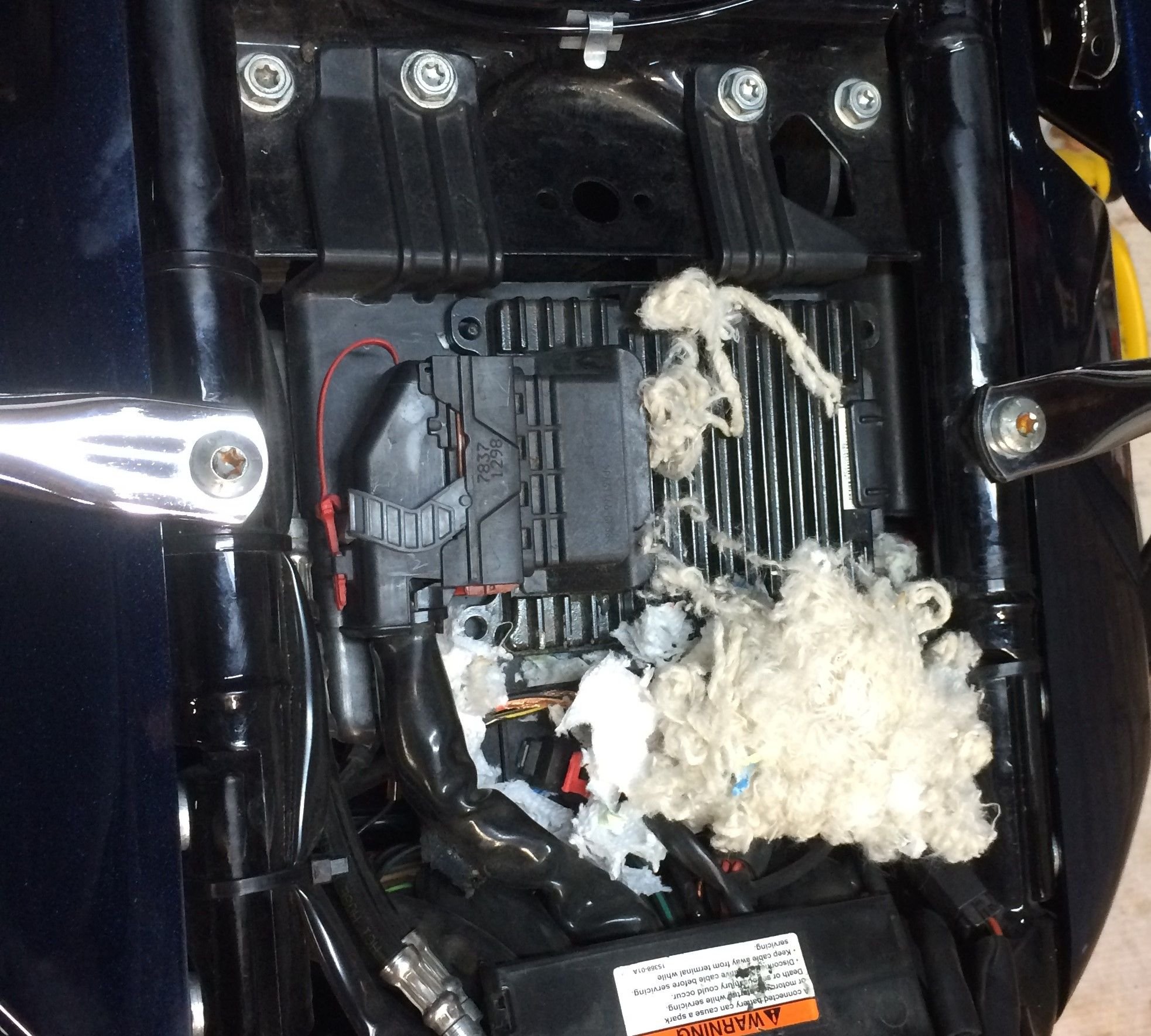

It looks like mouse damage to me too.
I would take the seat off and check under it. They like the warm engine when you pull in a garage or shed and can get into some tight places and cause expensive damage.
I found this mess two days before leaving on a road trip a couple of years ago. He/she chewed the wiring harness that connects to the security module. He even sharpened his teeth on the cooling fins on the ECM.
Cost $10 and some change and took less than 15 minutes for me to change it out. Probably one of the cheapest parts on a Harley Davidson. Dealer had one in stock too.
Notice in the first pic the wire that was chewed is less than a half inch from the harness that leads to the ECM. Chewing into that would have been more than a $10 fix.
Why they like to chew wiring is beyond me.

SO I forgot to post back in here the results of taking it to the dealership. What they determined was that a mouse did in fact get into the fairing and had himself some fun. What they brought to my attention was that the speaker wire on the right side (looking at front of the bike) going to the speaker box was completely chewed, leaving no actual covering to the wire. I didnt realize this in the beginning or wouldn't have thought that it was the antenna burning through the wiring. Worst part about the whole thing is that the replacement for that wiring harness was about $12.99 but cost me almost 2 hours of labor between them going through to make sure there was no more damage and to put everything back together. It is what it is. I'm just glad that it wasn't actually something wrong with the wiring of the bike that would cause issues moving forward.
Appreciate all the feedback on this post from everyone.
