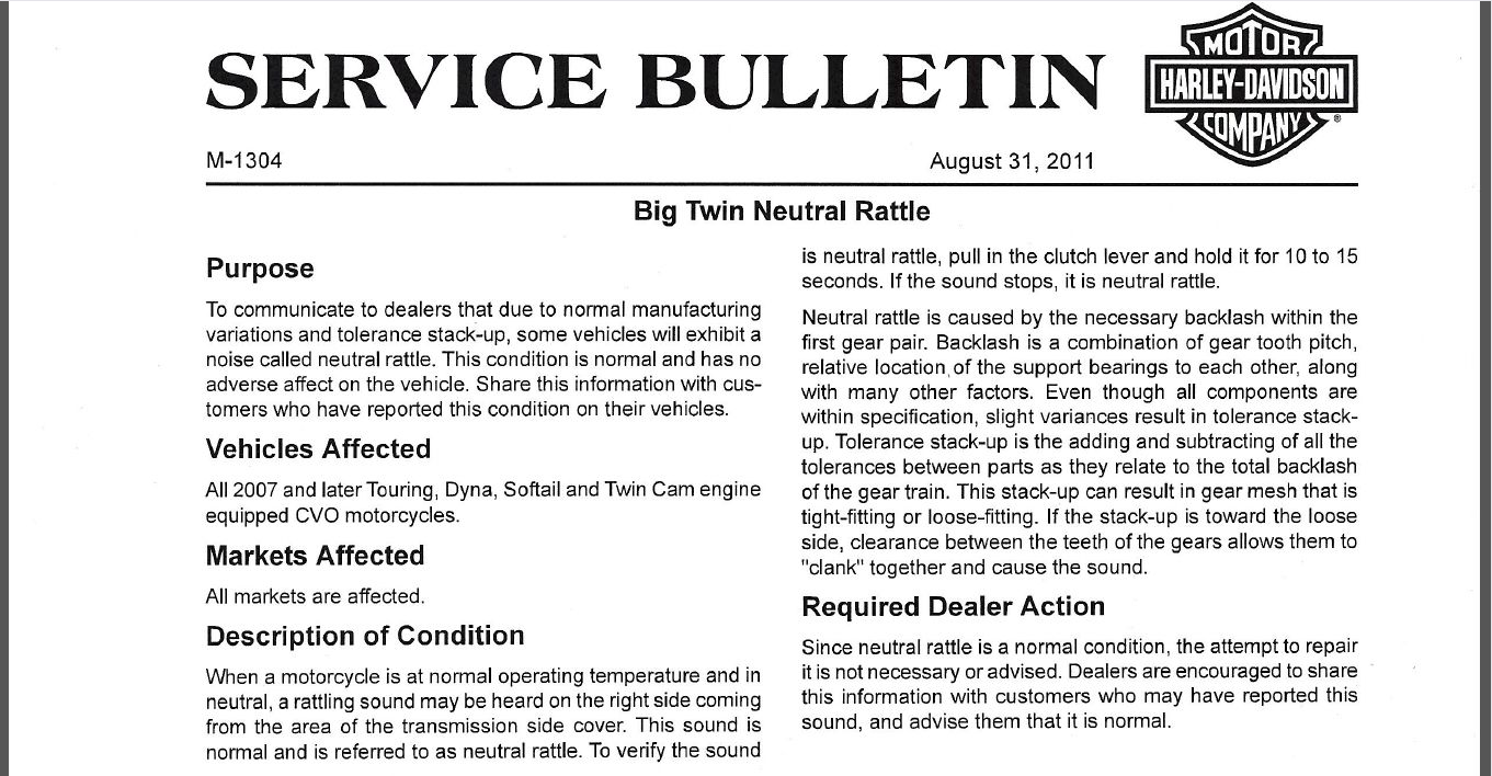

This was back from 2011 but helpful. If it was neutral rattle it would come from the right side of the bike.

Thank you very much for the post! I really appreciate it!

Originally Posted by ElectraJim
So, you think it's chain tension? Too loose? Too tight??
Thank you!!
Ya when they start to ware out they make noise. $35 fix
