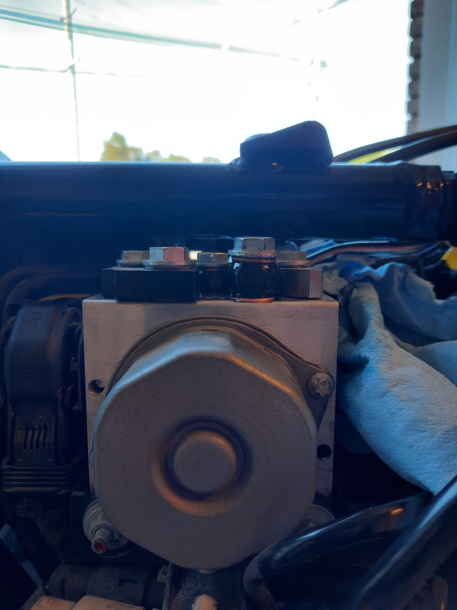

Also as for an update on my handlebar swap: I done goofed. When torquing down the banjo bolt on the ABS module for the new brake line, I took the threads right out of the block.... I think I sat on my garage floor for 15 minutes contemplating putting the bike up for sale.
Here's a pic.
So I got the new lines from LA Choppers. I already sent them an email this morning but it seems like the connector is way thicker than stock and I don't think the banjo bolt was getting enough threads to torque down to spec.
I'm gonna see if I can get a heli coil down there. Don't know what else to do. Pretty sure a new ABS module is north of $900 in Canada

Use a Time Sert instead of helicoil
Wow I just Google it and a Time Sert sounds much better. I never heard of it before. You can always learn something on this forum!
I actually have to! They're the only company I saw that makes an insert for 7/16-24.
Hopefully can get this done in time for my trip out West on the 24th
