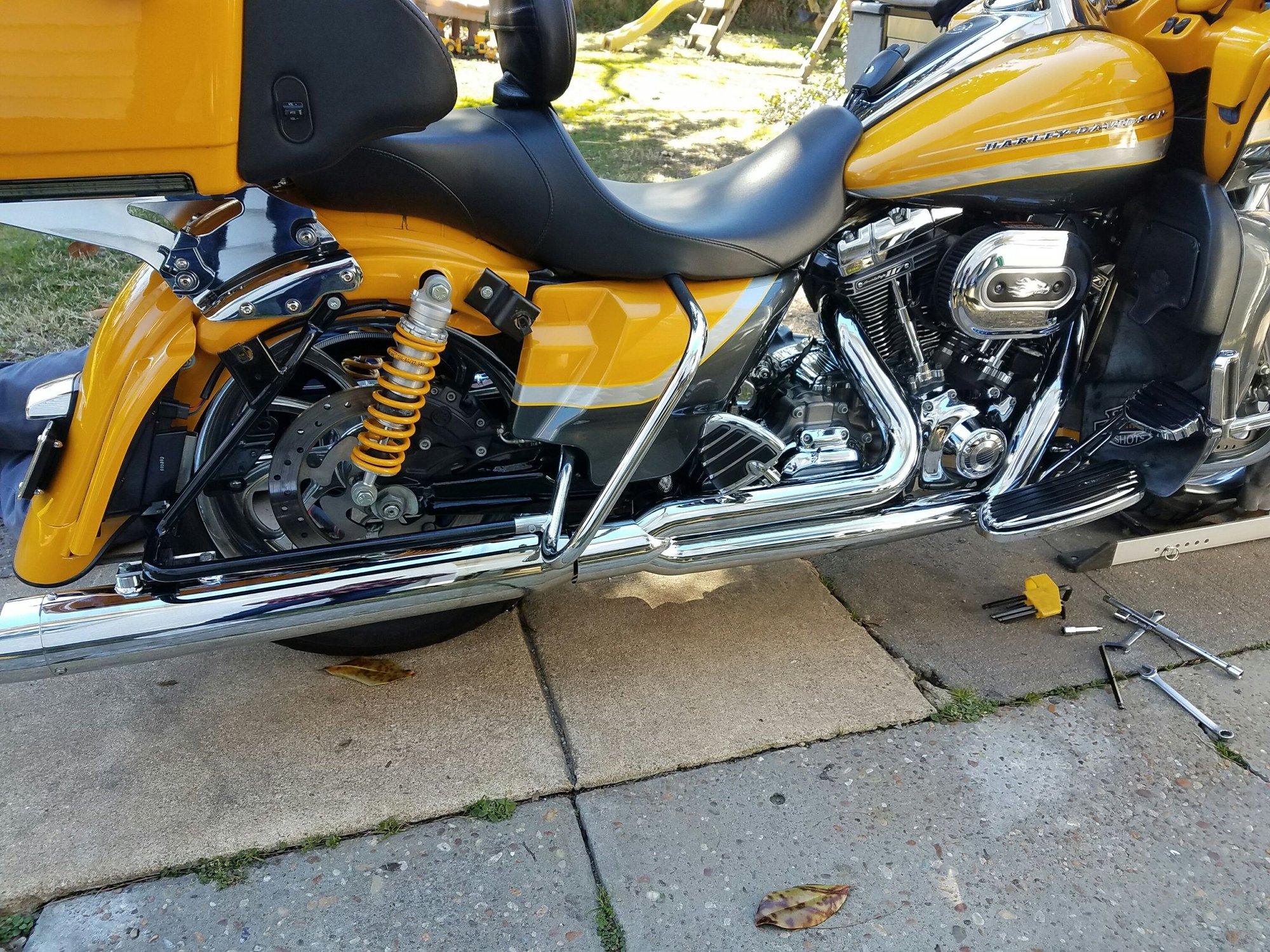

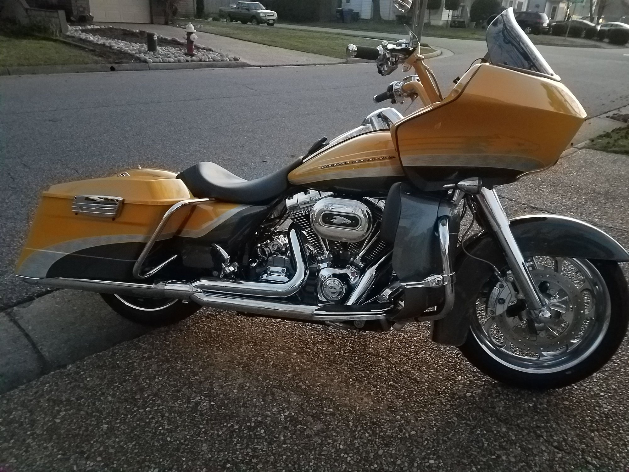

For the past Seven+ years I have been a big fan and still highly recommended Fullsac X-Pipe and Fullsac CVO baffles. Proven performance, value, for the price is second to none period!!!
When I decide to take my 110" Stage II up a notch to my current 117" Stage III, I wanted to try something else.
I choose Drago's Dracula II 2-1 pipes with a ghost pipe. So far I am pretty damn stoked!!!
(Heavypic, my bro is in the same boat as you. He has been waiting almost 1 1/2 months for his exhaust.)
YB
Rightly:
Lefty:
All buttoned up:
