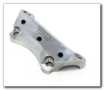

This is what I used when I did my bars. Once locked down, those bars ain't going nowhere.
http://baggernation.com/item.php?iid=75
