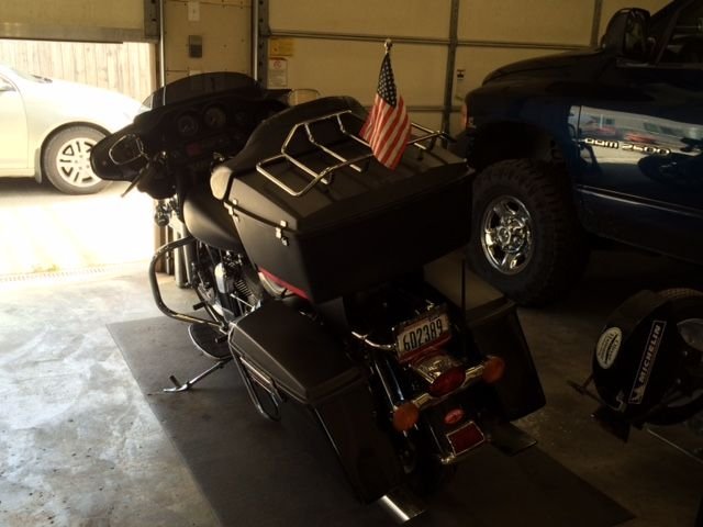

Originally Posted by whocares
Drill a small hole at end of the crack.this should stop any further cracking.
How bad is the crack???
Then repair it your self.
Plastic weld or epoxy (prep it right before you start).
If it was fiber glass you can repair them with resign and glass (or carbon fiber cloth).
My old bike's tour pack was a loaded (all the lights and a sub hole).
When I got done it was...... (not the best picture, but you get the point).
