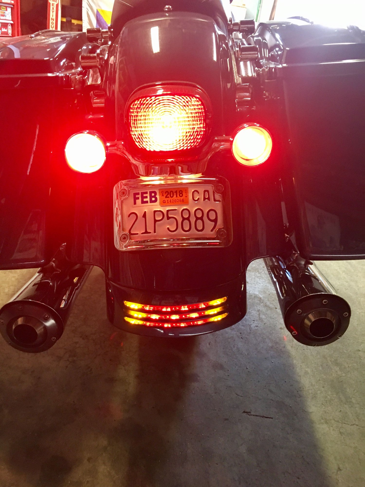

How do I make my LED Fender Tip light turn as my signal lights? Harley Davidson Street Glide Special, I want them to blink just like my turn signal

I'm positive you can't do that with the factory lights unless you know how to modify circuit boards. I bought my tri-bar light on eBay. There are a bunch of companies selling them. It has run, brake and turn signals. The run and brake circuits are included with the factory plug. The turn signals you have to splice into the factory wires, it wasn't hard. With the regular turn signals set up as run brake I now have 4 running lights, 4 brake lights and two signals per side. Also it has over 30 LED's compared to the five the factory light has. There are companies (probably made in the USA) that sell a unit like this for over $100. I took a chance on one of the many selling them from China for under $25. It has worked great for two years
