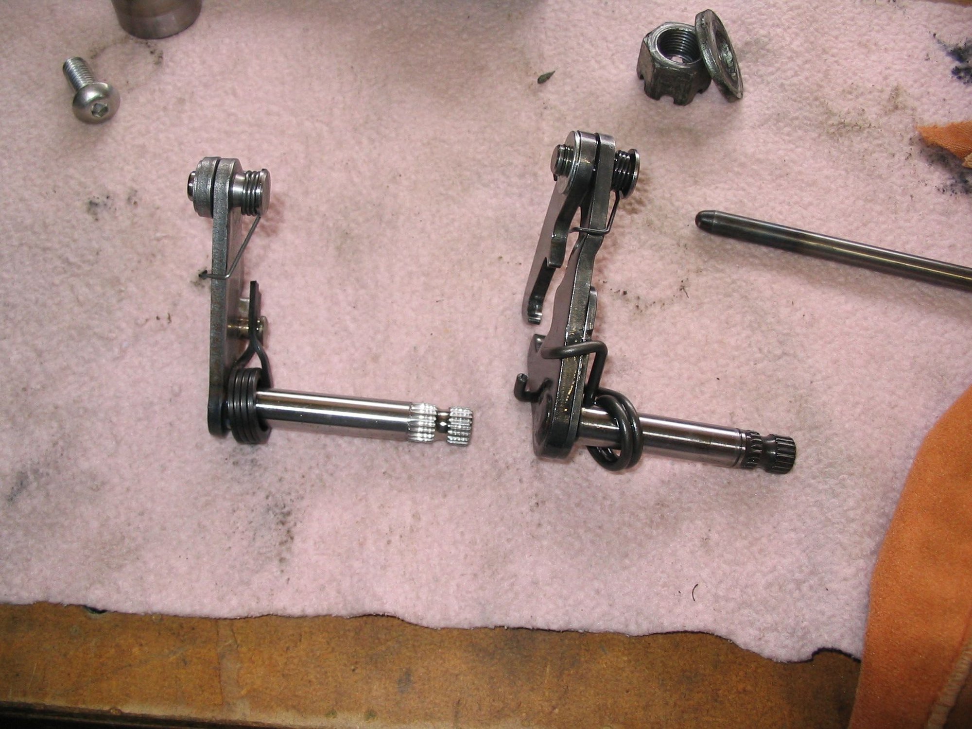

Anyone else have a problem with Baker? I bought one of their anti overshift pawls, installed it & it is having a hard time down shifting. Getting false neutrals, won't down shift unless you blip the throttle just right, & 1st is impossible from neutral (you have to bump it into 2nd & then down into first. I made sure that the adjustment eccentric was at 12 o'clock, adjusted it forward & rearward in small increments up to 1/4 turn each way, still the same. I have contacted Baker, all they have to say is it sounds like you are doing everything right. Maybe the shift drum has been changed or something else in the trans has been changed out. Or that maybe they did a shift drum change & I have to buy a different shift drum. Or just not get back to me. I took the original pawl lever & put it on, you can down shift (if you press down on the lever) & up shift but the lever is not parallel to the dowel & the talon at the rear is too high. Baker also said that the lever should be close to what the stock is but it is far from close.

I have the over-shift shift arm in my 2000 FXDX. It corrected the over shift and did not make any difference on upshifting (except the over shift) or down shifting.. I would check to make sure that when you reassembled stuff, that none of the arms are touching anything. A 99 still have the shift pawl adjustment and it may not be adjusted correctly.

Don't worry, I have thick skin. As for do I know what I am doing, I believe so. Been a mechanic for 40+ years, ASE Master Tech. I can rebuild transmissions standard & automatics, engines, diag problems ect ect ect. I have replaced the head gaskets, put in an alternator, changed the gearing & belt to put a 150-80-16 rear tire, put in gear drive cams & put on the DIY air ride. But I am human. I looked over everything again, sometimes it pays to walk away when you are dealing with a problem, & most of the time it is an easy thing or the simplest thing there is. I am finding I have 2 problems, 1st was when I put it back together I leaned the lever forward more that I had it before, still at a decent angle for the clearance in the transmission, but the lever going through the primary case, not, it had some clearance issues underneath. Short fix, shorten the rod that connects the 2 levers. Took it for a ride, downshifts & up shifts, but I think the new (5 months) heim joints on the linkage are tight, will relube everything & try again. I was a little disappointed with Bakers service, just seemed like oh well you have a problem good luck, or spend more money. This was my fault as to why it did what it did, I was just hoping that maybe someone else had the same problem, but instead get told to take it to a shop to get it worked on, like they don't hire idiots once in a while. Just glad I figured out what the problem was, just wish I had noticed it sooner. But when you work on vehicles all day & the shop is hotter than, well I will stop there. I just don't feel like working on anything when I get home, so it waits for the weekend. Thanks
