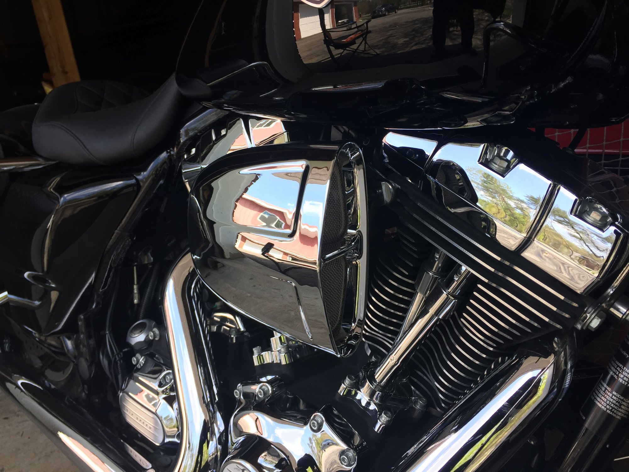

I put this cobra one on. Has a K&N conical filter inside. I like it
