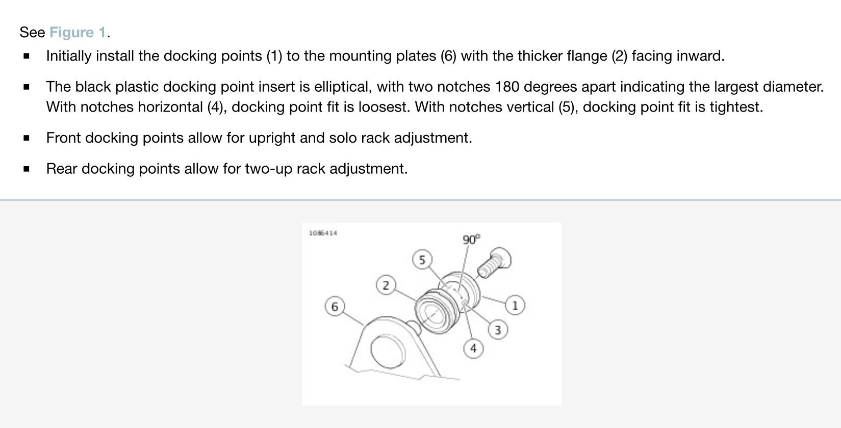

I bought the 4 point docking kit from Surdyke, and the sissy bar from my dealer. The rear docking slots on the sissy bar are too narrow for the spacer/docking points. Anyone else have this problem?

Edit: Duh...I just though of testing if the latch will go over the spacer...and it won't!! Crap..hopefully HD can bail me out, or I just ate the cost of the docking assembly.

You can turn the spacers around to give you more lateral clearance if you need it. Notice that one end is thicker than the other.
Also, the black plastic piece isn't perfectly round. It's oblong so that you can turn the spindle to adjust how tight of a fit you want. The instructions spell out how to do all of this with regard to notches that are imprinted on the spindle.

OP: Oh crap!! I put the chrome spacers on the outside...whereas they are supposed to go on the inside. With this correction, and rotating the bushings to the loosest position.everything went in place like butter on a hot skillet. And the rack and sissy bar are solid.

Haha, hey, it happens. Glad you got it figured out before taking it back to HD. If you use the backrest a lot or find yourself constantly putting it on and taking it off, be aware that those plastic spindles will wear and you may experience a loose fit over time. Easy fix since you can just rotate them to tighten the fit back up.
