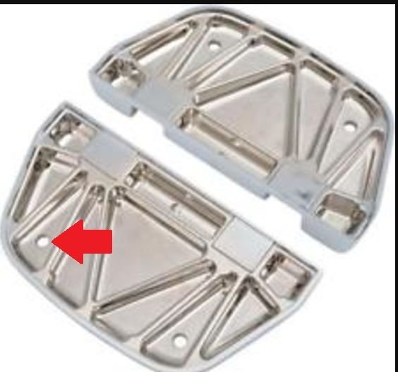

Passenger floorboards....used bike I bought has passenger floorboard covers. Issue is, they had to drill into the floorboard to insert screws to hold them on (see photo) -which is why I was never a fan of an add on like this.
Sure enough 1-2 screws fell out riding (drilled holes are stripped out).
While fixing this, I pulled the rubber floorboard insert out of the board but cannot get it back in. You have to push the 2 rubber nubs through the holes which is not as easy as it seems. I lubed them, tried pushing through no luck...tried looping dental floss around to pull through the hole- all that did is rip one of the ends off (the hemisphere rubber head is slightly bigger then the hole)

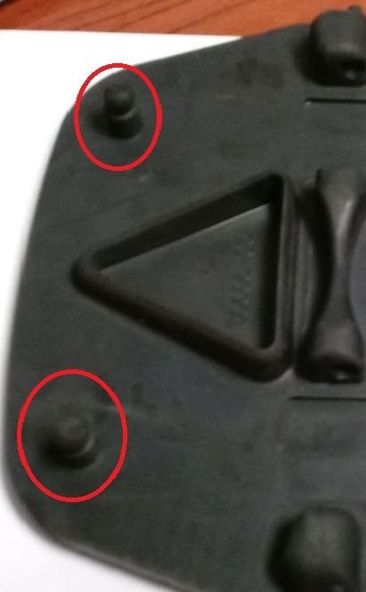

holes in passenger floorboards. the rubber 'nubs' need to go through these. The nubs are slightly larger then the holes
rubber 'nub' goes through hole in passenger floorboard
two nubs per rubber insert

The original nubs have a long thin piece of rubber that you pull on to get the round part of the nub through the hole. When pulling, it stretches and thins out the round part. Those are usually cut off after install. Just gotta work it to reinstall.

Using Dawn dishwashing liquid on the rubber "nubs" can help and I've also used small, flat blade screwdrivers to "assist" getting the "nubs" through the holes far enough to "pinch" them and pull hem through the holes using flat-nosed, needle-nose pliers.
Just don't pull on them too hard as they can break or pull apart.

Don't think you can pound them through? Meant to be pulled through (stretches them thinner).
I used pliers to pull them through. I pulled one nub through easily then couldn't get the second one in. Tried until I pulled one of the nubs off. Took the insert back and got new ones and had exactly the same problem.
Finally changed which nub I pulled through first and it then second went through easily.
If you have get one in but have problems with the second just change which one you pull through first.

I've done it. You need to be persistent yet careful. It's not something I will do again, without LONG consideration! Lubrication and a small old blunt screwdriver, to gently pry the **** through the holes.
