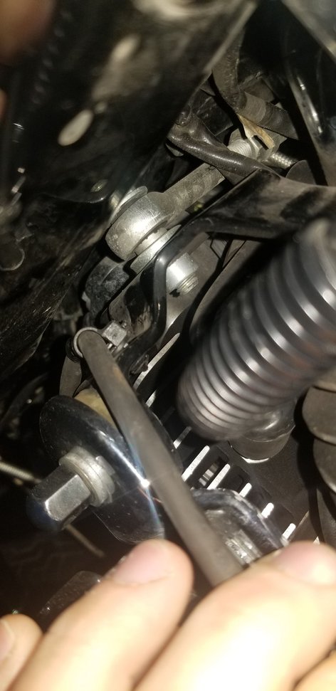

pretty sure I could kiss you right now.
I've a rattling noise coming off the throttle, cruising under a certain rpm and over hard bumps.
Pulled my primary case apart and my chain tensioner was destroyed. Bought a new one. Same noise. Checked everything.. heat shield mounts...shifter linkage.. kickstand against frame. Etc etc.. just about everything except motor mounts.. read this reply and checked....
it is currently 440am. October 24th 2020 lol
im praying this is it.. otherwise it's going to be the compensator.. that's the only thing left if this doesnt fix it

Mounts would have been what I checked first.
Only because I had this happen on a van transmission years ago.
Drove me nuts until I found it.
