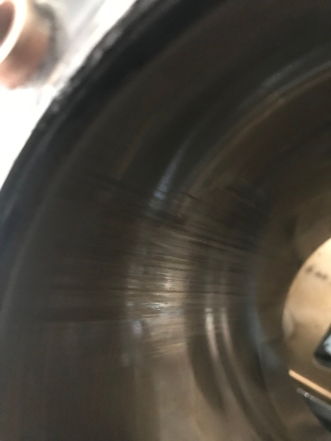

found the source of the noise

Ouch!! Any indication as to what caused the damage?

Think it might have been a crappy tune. I had a dealership dyno tune it about a year and a half ago. They said they knows what they were doing with a PowerVision.
I always felt that it was leaving some on the table performance wise, so I had a independent ship with proven results with powervisions tune it. They said the dealer tune was all screwed up and the front cylinder was way too lean. Guess which cylinder was bad.
i got it put back together this morning, what a difference. Still breaking it in but I don’t remember it ever being this quiet.
