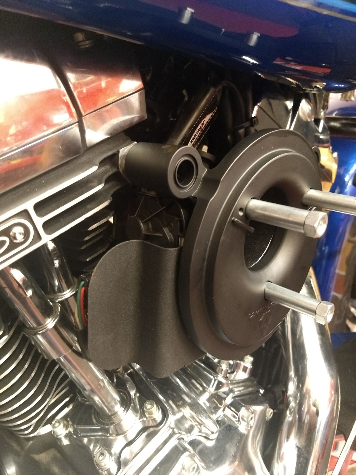

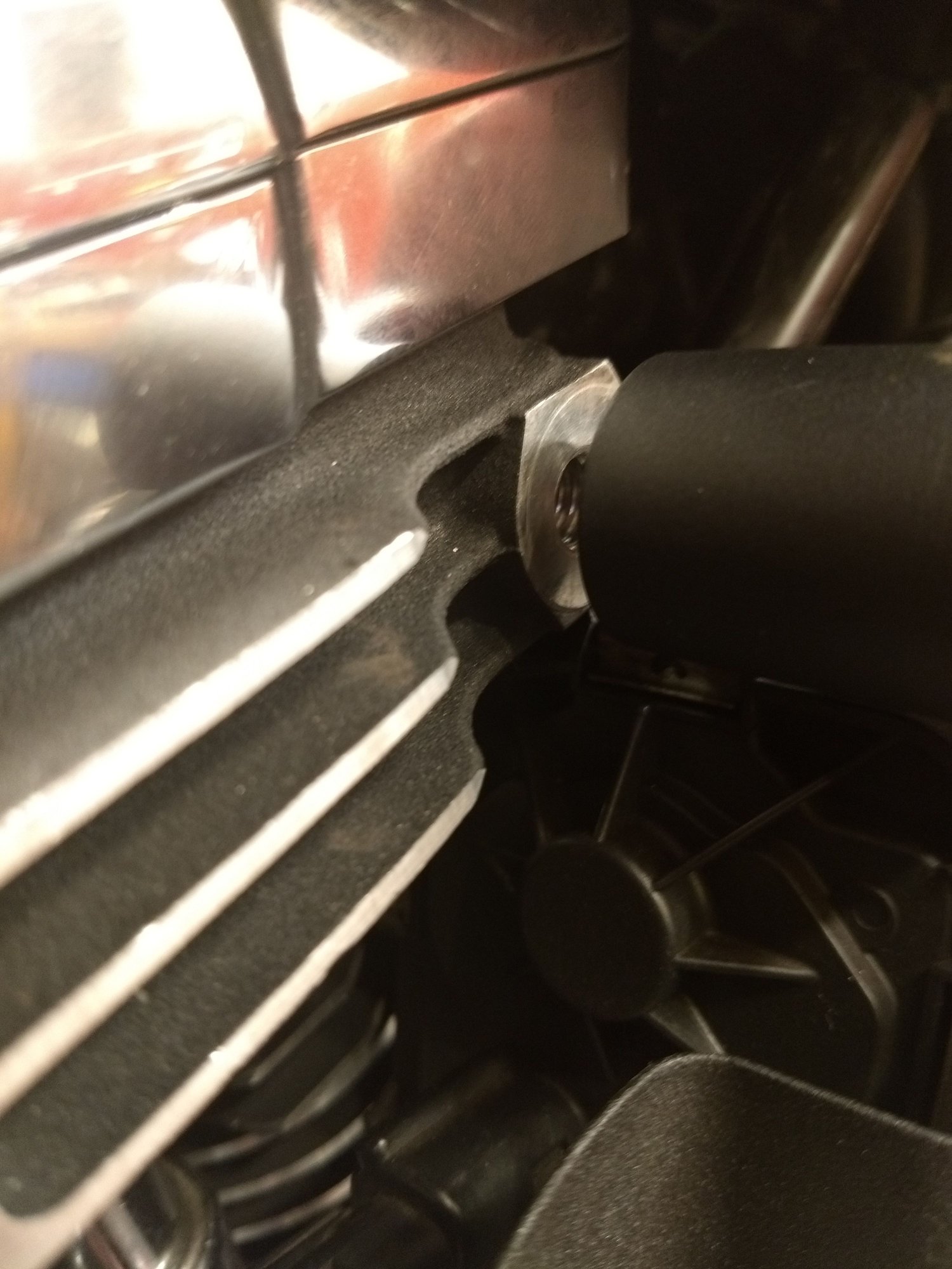

Got the bike basically all back together except for fluids and the air cleaner. Air cleaner is giving me some issues. Have wanted to change it out since I bought the bike and now is as good a time as any. Went with the Big Sucker Derby. As you can see in the pic there is a gap between the head and the backing plate. Instructions say the 'Injection Module Bracket" must be used, presumably as a spacer. My bike did not come with said spacer. I realize I could buy the bracket but does anyone have any other ideas of what I could use?
Just go to the hardware store and get a spacer or stack washers to fill the gap.

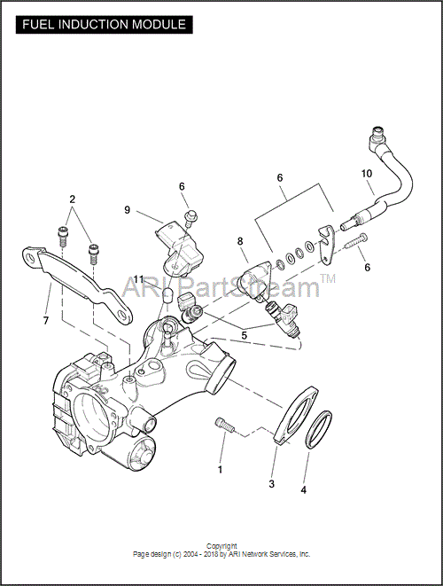

Go to the dealer and buy an injection module bracket. You will probably have to order it but I bet it's not expensive.
Old Mar 16, 2018 | 09:31 PM
  #167
skydude426's Avatar
skydude426
Joined: Sep 2010
Posts: 1,677
Likes: 434
I just looked on a Harley parts finder. $15.27

Originally Posted by hbsoldier3
How is a by-pass kit gonna solve his gap problem? I have Dk's kit, but I just route the tube under the frame, no catch can.
The banjo fiting would take up the gap if you got the kit with the catch can.
