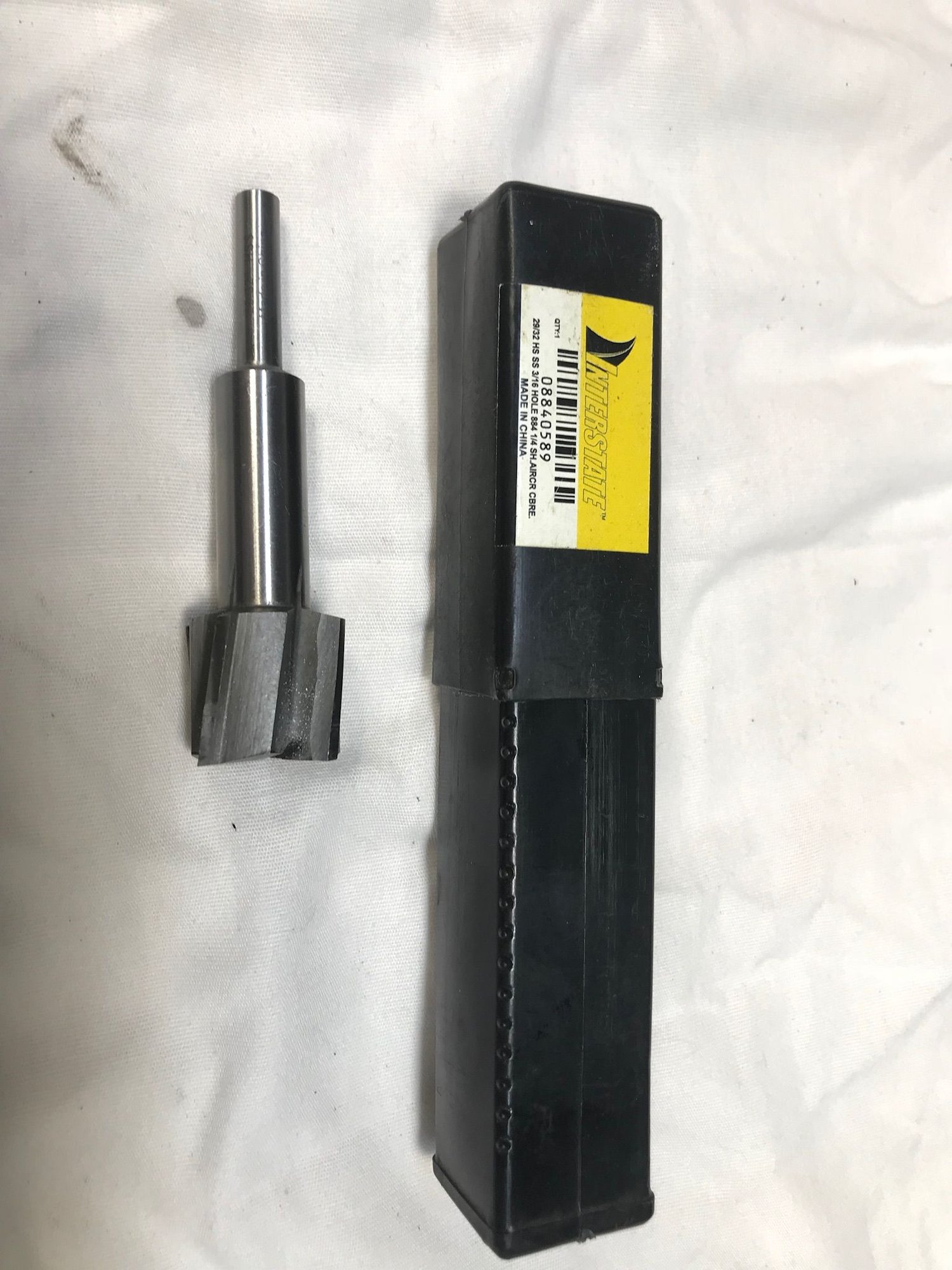

So I am doing the breather mod with the Kuryakyn 1 3/4" breather bolts and Rushmore tubes. The Kuryakyn bolts are to short. Does anyone know where I can get that style bolt but in a 2 1/4" lenght?
I had the same problem using a Screaming Eagle back plate for the air cleaner. The 1 3/4" bolts were the longest I could find. I bought a counter bore bit on eBay, made a jig to hold the air cleaner back plate on my drill press, and counter bored the holes in the air cleaner back plate deeper so more of the breather bolt could go into the head.
Do you remember what size bit you used and how deep you drilled it?

I used a 29/32" bit and counterbored it in close to 1/2". The 1-3/4" breather bolt protruded out of the air cleaner plate about 1/4" before counterboring. Afterwards it protruded close to 3/4". Here's the bit and the aircleaner after install. Sorry I didn't take pictures of the work as it progressed.
