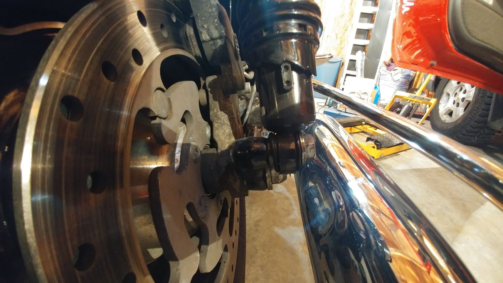

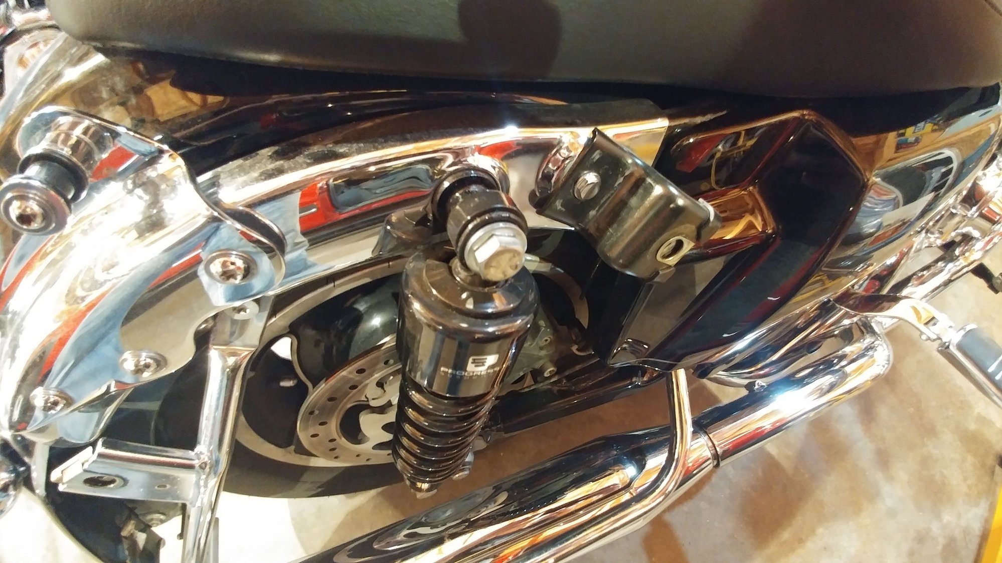

Installed the 412 HD 12" shocks recently and now have noticed they look to be installed wrong. The instructions are not super clear and said use the bushing with the edge how I have it I believe and one washer per eyelet but as you see inside the shock the rubber part looks like it is coming out and like I need to add an inside washer as well like the outside but the spacer edge is there but it doesn't keep the rubber bushing in flush. I can't find **** for up close install pics. I found threads on sporty forums talking about if you install these wrong your ride will suffer. That might explain why these ride like crap. I'm 250 my GF is only 5'1" lets just say that and with some gear we bottom out on number 4 setting and these are the HD shocks even.....also should I rotate them so the bottom is different. I recall them saying you can rotate the bottom in or out for clerence needs but they look fine to me.

Well, as long as things are lined up correctly, the installation should be fine. It's just a matter of getting the spacers in the right location, and that may be something that you don't really need too many instructions for!

Did you torque to spec? you may be compressing the rubber bushing and its busting out.

On the bottom there should be a washer in there. It's going ruin the bushing the way it is. I read the instructions, it says to install with the same hardware the old one were removed with. Do you remember if there was a washer behind the shock on the bottom? Call progressive, they should be able to tell you for sure.
Also, I recommend you lower the bike and tighten the shocks with the weight of the bike on the shocks. Doing this will prevent the bushings from "winding up" when the shocks compress.

^^What he said. The top looks fine but the bottom eyelet should be straight up and down in the bushing, not a an angle. It looks like it needs some kind of spacer or washer on the bottom behind the bushing.

Thanks guys. Yeah I can't remember what was there as the bike had a lowering kit installed when I got it. I have extra washers to use.

Called them how I have them is right and how their instructions say. That collared sleeve to me tho doesnt have a big enough edge on it to hold the rubber bushing in there. They said I can pull the shocks and lube up the rubber bushing to slid it back in but no washer on the inside is used. They are torqued to spec and red lock tight was used to hold them on. Guess ill just have to ride her.
