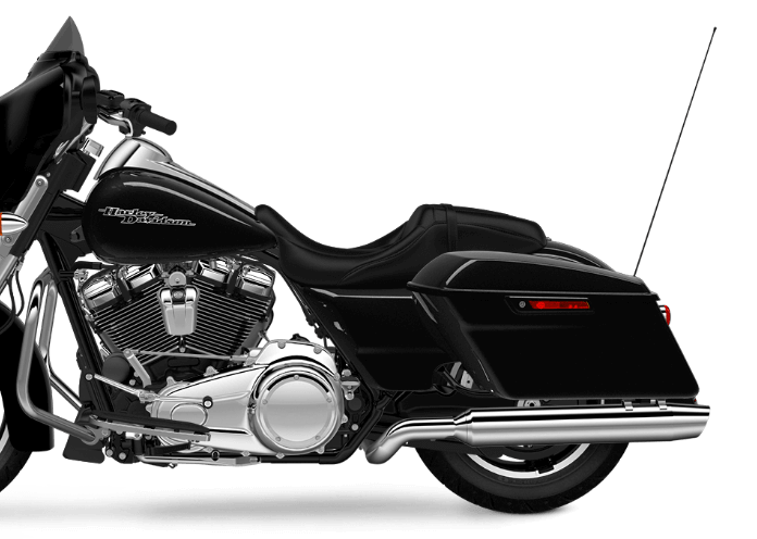

What's the rationale behind the factory end caps on stock mufflers, I'm trying to work it out.
I'm in the process of customizing an RB Racing pipe, removing the vulgar balony slashcut to the side and looking to replace it with a standard H-D one to make a kind of "sleeper" pipe. Coincidentally, both their main canisters are the same OD. The RB is, obviously, a lot emptier and free flowing.
On most older models, H-D used their more subtle slashcut with the bottom side sticking out further. On some, the 2017 Street Glide being one, they use put the slashcut to the top, see below. (On others, like the 2-into-1 Street Glides, they use just a plain taper).
I think I get that the older design from a visual perspective. The line follows the line of the saddlebags nicely. But from a functional point of view, it sucks because by sticking out more, like an underbitten jaw, it catches and fills with rain, and then rusts. Bad end.
And there's another functional benefit when it comes to back up to sidewalks too. If you've got a slashcut to the bottom, the tip is going to hit first and damage. Rust again.
I don't imagine many folk will follow this or have an interest in it, but the H-D design is actually surprisingly subtle and elegant. It's not just a straight tube with a cone on the end. It gradually tapers towards the end cone before tipping in.
Of course, perhaps this discussion also only matters to those of us to live and ride in places it rains but I've been looking at used pipes where they've suffered in this way!
The RB is older and had picked up some pitting in the chrome on the underside, I'm guessing from sand/gravel spray, and beneath the heat shield. Surprising once you remove it, how much it eats into the steel even though it still "looks" OK on the outside.
It seems the 2017 have all moved to 'top downs'. Did they have some straight cut tap ends for a few years too?
Visually, I like the 'bottoms up' but functionally 'top downs' win. The straight cuts look a bit old, like FXR/Sportster pipes. The worst have to be the round ends they used with the heavy catalyst pipes, which also come in a 4". They are not even in the contending.
What was going on here, H-D just ekeing the parts bin out by flipping the pipes for another year, or some kind of thought?

Interesting points, and I've had similar observations and thoughts about the "slash" design. Since the SE Street Cannons can have the end cap on slash-up or slash-down, I've noticed that most that have them in this area have them installed slash-up. The lines follow the bags perfectly, but I personally don't like the look.
