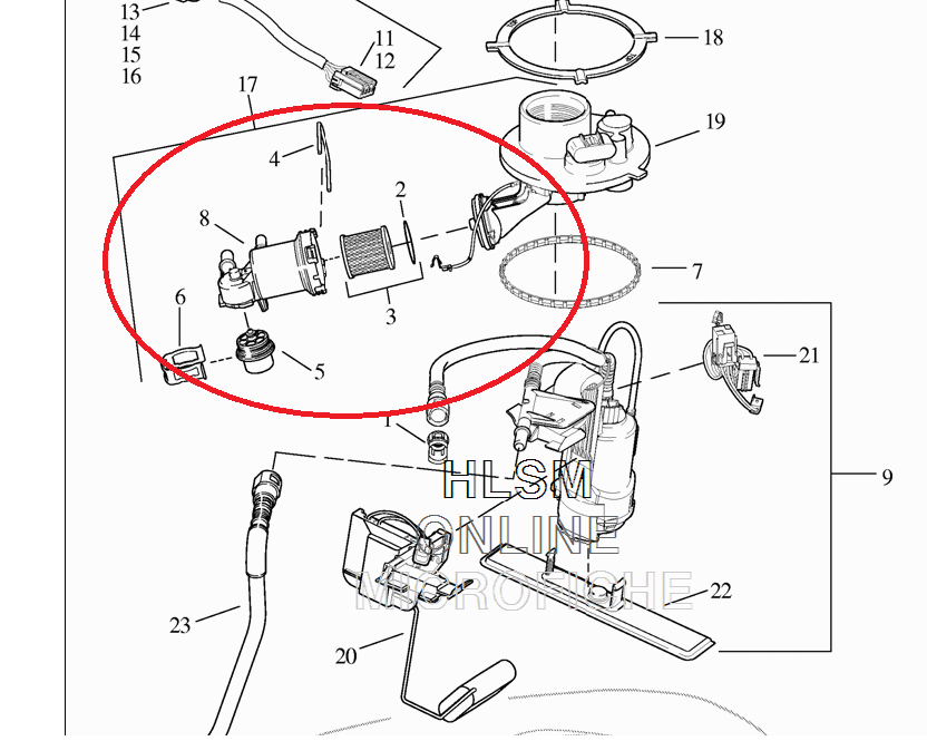

#8 is the fuel filter shell. #4 is the retainer that goes through the shell to hold it tightly to #19. The tabs with holes through them on #8 can break and then gas sprays out around the o-ring #2. I have had this happen twice. The new filter shells are thicker to resist breaking. That and plugged filters have caused fuel pressure problems for me. The shell breaking is something that can definitely happen to a bike that is sitting. I have bought a lot of parts online from Surdyke

On a near empty tank that spraying gas could be from the regulator (#5 in the diagram) but I'm with Mike, it's probably your fuel filter shell cracked or dislodged.
Pull the console, and use a wood drift and rubber mallet to spin the cam (#18) loose - it's super easy, cover your tank with something first though. Pull the whole assembly up carefully and take a look at the fuel filter shell.
