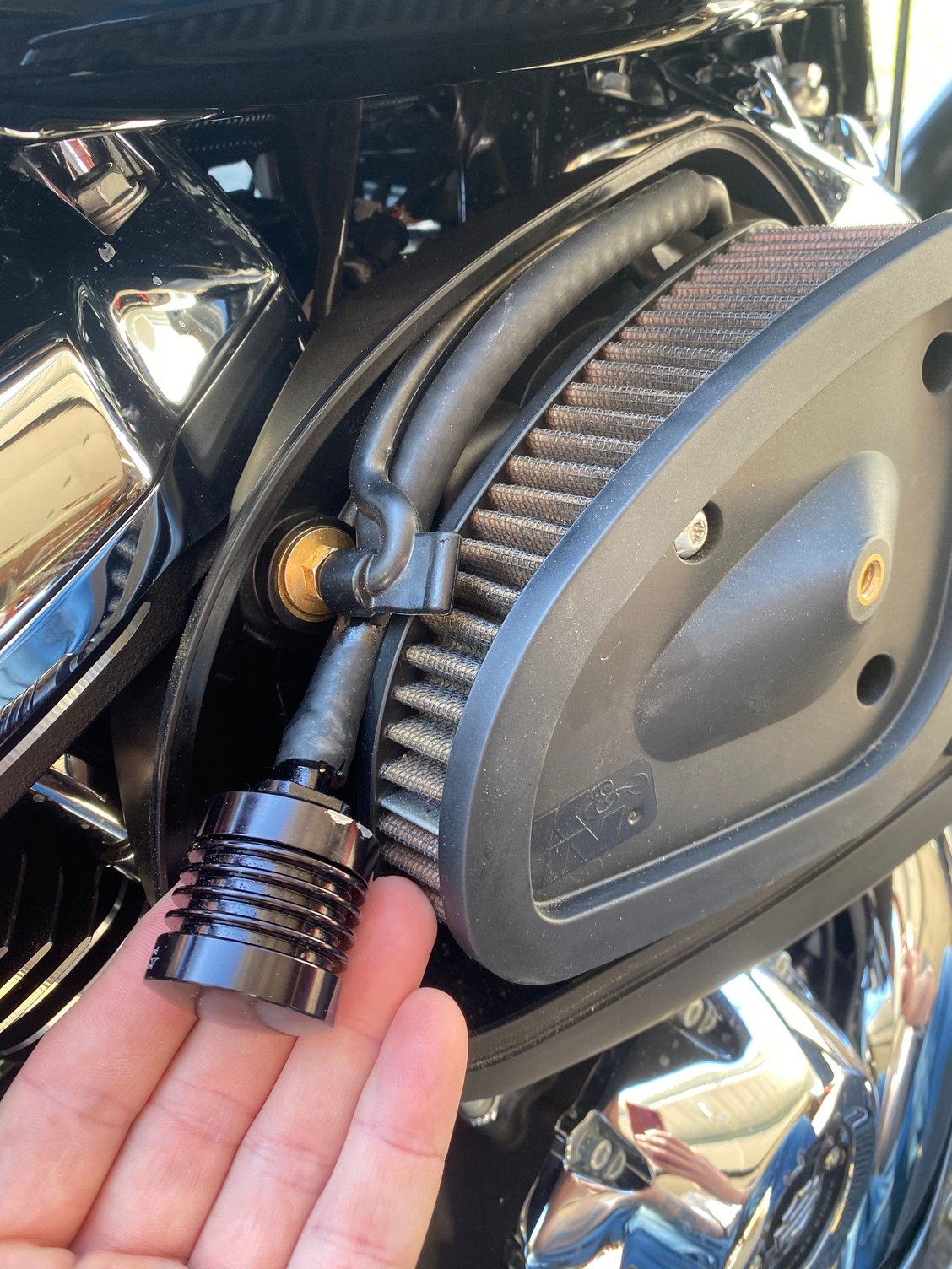

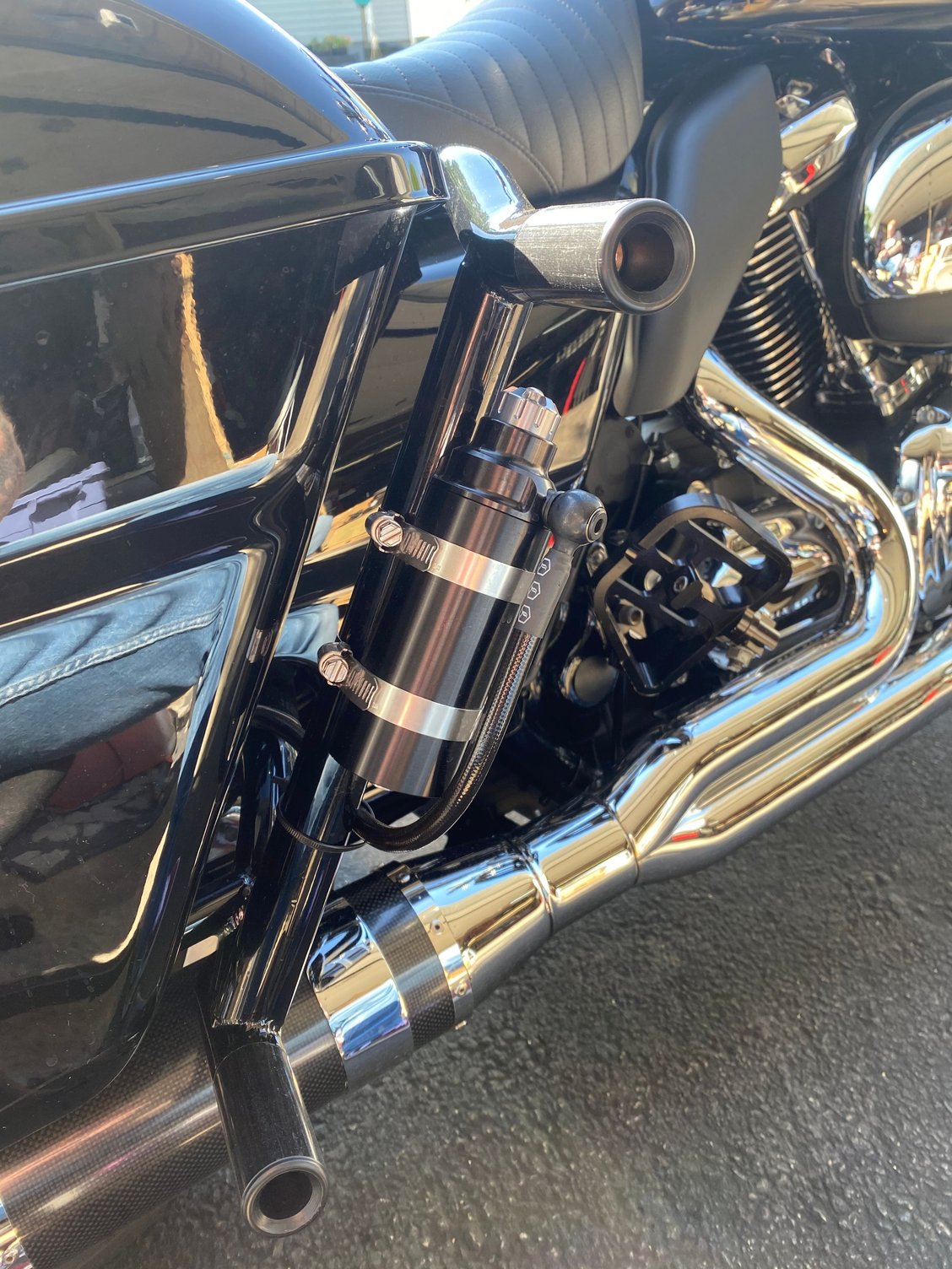

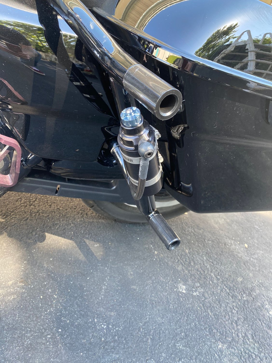

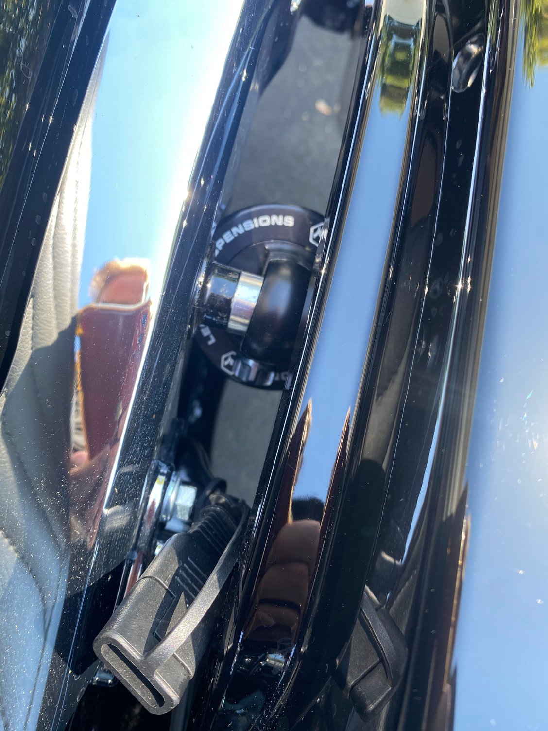

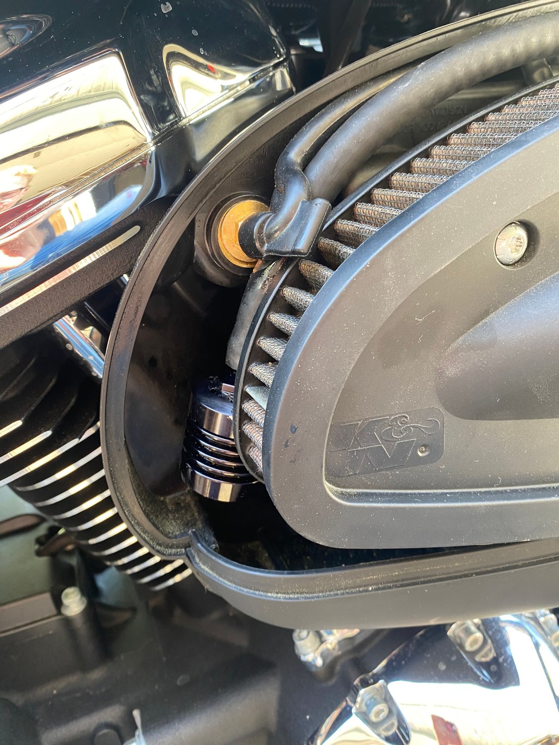

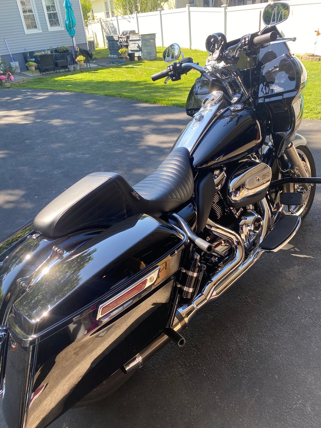

Here's an update on my FLHP. Since I got it home I simply took the existing breather hoses and put them inside a 3/8" hose and ran it to a Golan ($46 on eBay) breather/filter/catcher and just tucked it inside my stock air cleaner housing. I kept the stock air box and just replaced the stock air filter with a K&N inside. I put on a new set of Legend Arc with remote reservoirs. I installed them upside down because the **** for the rebound was under the bag and not quickly and easily accessible on the fly while sitting on the bike. Now I can just reach back a little and adjust them with 1 finger. The reservoirs were supposed to be clamped with the supplied billet ones between the bags and rear tire with the ***** facing out and rearward. Also not quickly accessible on the fly, and I hate the way they look back there like that. I took 50 cent stainless hose clamps and mounted them on the Santoro Fabworx crash bars. All adjustments for different riding and passenger can be done from sitting on the bike.

@Wheelup what front crash bar is that?

Santoro Fabworx
Killer set-up!
