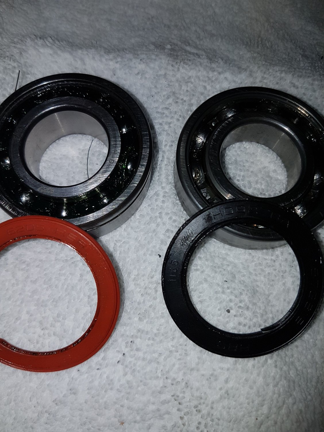

09 ultra- no histroy on replacement but when i had the bike on the lift i jacked up the tire and it spun nice and free no problems . But i decided the best way to clean these rims was to take them off . When i had them off i ran my fingers around the bearings and was not right so i pulled them today
The orange one was abs and it was fine the other side had very little grease in it and it was burnt and black inside ,most of the cheap wire cage was gone and the ball bearings were rubbing against each other (the roughness i felt) this would have failed for sure in the next year and im glad i pulled them
For me this will be part of yearly inspection
Like i said i have no history but my second year of ownership
Im putting All ***** bearings front and rear so i have a starting piont if there are future problems
Dave

I see a lot of bearings with that vaseline looking stuff in the bearing on the right, especially photos of ones that failed. When I run across that stuff in new bearings, I clean it out and put in a good quality name brand synthetic - and more of it than that bearing has. I lightened the photo so folks can see what I'm talking about.
I've used AllBalls in 3 motorcycles now, so far with no problems. They're double sealed on each side, have heavy ball cages, and are well packed with Chevron green synthetic. Might be Chinese made, but they're way better than Harley's Chinese made bearings, and have them in abs sizes, too.

A lot of trurth in that , bothers me that that bearing passed the rear tire spin push pull test - was shocked how bad it was
Not knocking anybody but unless wheel is pulled no one can say that bearing is fine until you get your fingers on it
