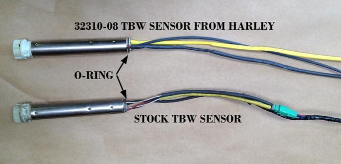

This was my winter project 2 years ago. I installed these exact bars (1.25" version) on my 2012 UC. Took my time and ran all wiring internally. Do yourself a favour and get rid of the stock twist grip sensor. Take the advice of many here and get yourself the Screamin Eagle version (32310-08). I was able to re-route all the wiring so no extensions...tight but works. I'm thinking of heated grips and may end up adding extensions at that point...just to give a bit more play in all the wiring. Adjusted the stock brake line to fit...no problem. I did end up using a longer clutch cable as I wanted it through the hole in the fairing in it's stock location. Stock cable re-routed works...but tight.

Thank you for the information. Just curious what is the difference between the twist grip sensors?

Stock grip has a little green connector that can cause issues, the 32310-08 does not. Rather, it has straight wiring.
