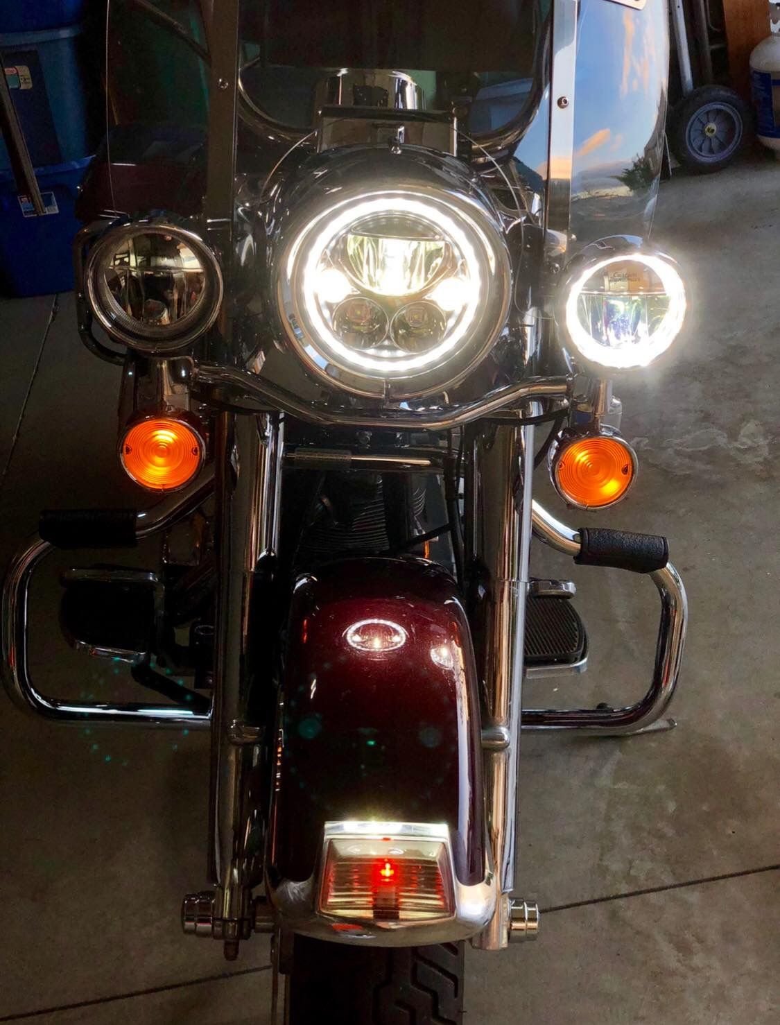

It was a polarity issue guys. Harley had reversed the wires in the right side Passing Lamp Connector at the factory. It never mattered using the stock incandescent lamps. Now that they’re working, WOW....What a difference!
Thanks to each of you for sharing your thoughts and ideas.

Post some pics if you can, thanx.

Awesome! Congrats!
