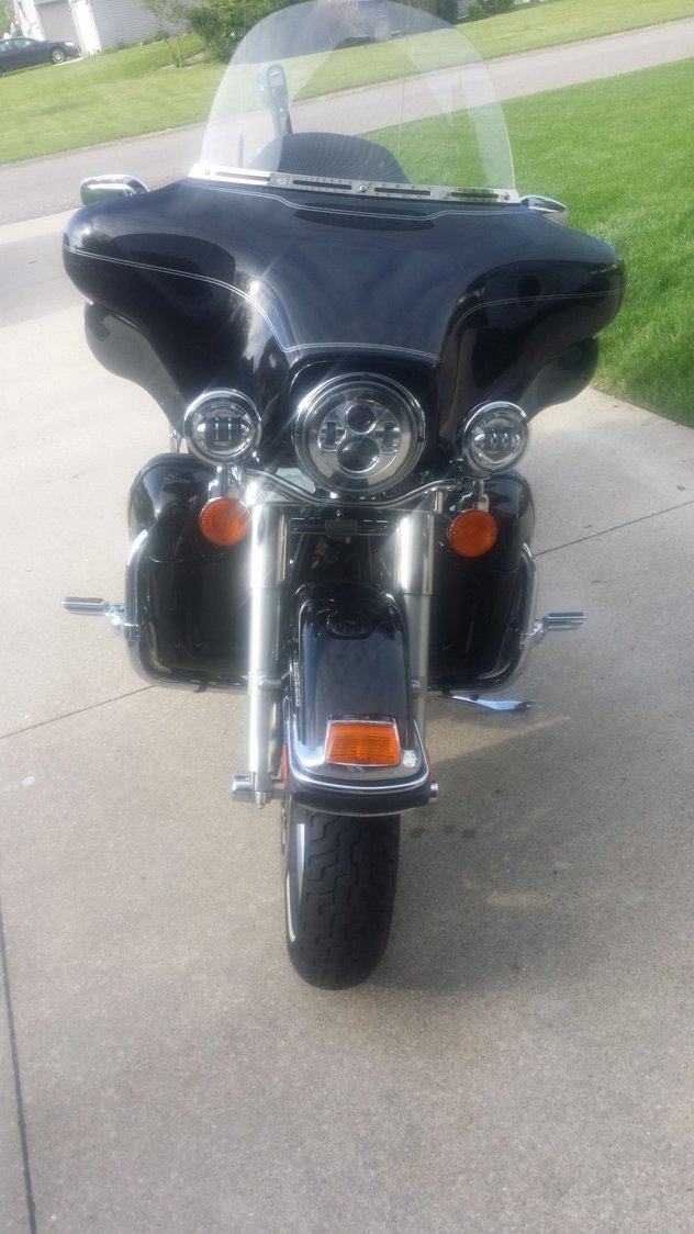

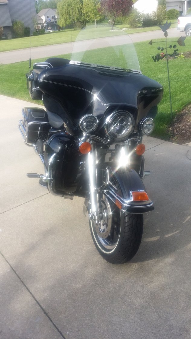

I installed the sunpie lights on a 2008 ultra. The only thing I had to do was put a longer screw in the headlight trim. Everything else plugged right in.

The sunpie lights on my ultra... .. They really light up the road in the morning! Huge difference compared to the stock lights. Well worth the money
