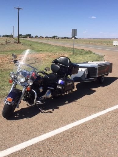

The engine in my '99 Road King has always had a tendency to ping a bit since I had an independent shop install a bigbore kit, SE HTCC heads, SE HTCC pistons (10.25-1 compression IIRC), and SE 203 cams. That was 40k miles ago. I wanted it to have a bunch of bottom end torque and folks who have ridden her are always impressed. I'm usually able to overcome the pinging by adding a bit of octane booster liquid. It all depends on rider/passenger weights, air temps, elevation and the quality of fuel I use, but it mostly only
pings on long hills. Out west here, because of the elevation, gas refineries are allowed to sell fuels a few points less octane than the rest of the country, so I'm already starting with an octane handicap.
Yesterday I hooked up to my newly purchased used Time Out camper for its first time run and it pinged almost the whole ride. The camper weighs about 200 pounds more than my usual passenger (she was not with me yesterday). Sounds like a bunch of ball bearings in the heads. I had a full tank of Chevron Premium (I try to always use good premium gas) and once I had the chance, I added some octane booster to the tank. Didn't help. Once I dropped the camper off, the bike ran great again so I'm sure it was the extra weight, along with the 90 degree temps, and 7000' elevation.
Would you think it might need to retard the timing a bit? Can I even do that? Is there anything in the bike's "brain" that senses the pinging and adjusts itself?
Thanks in advance for any thoughts or suggestions.
