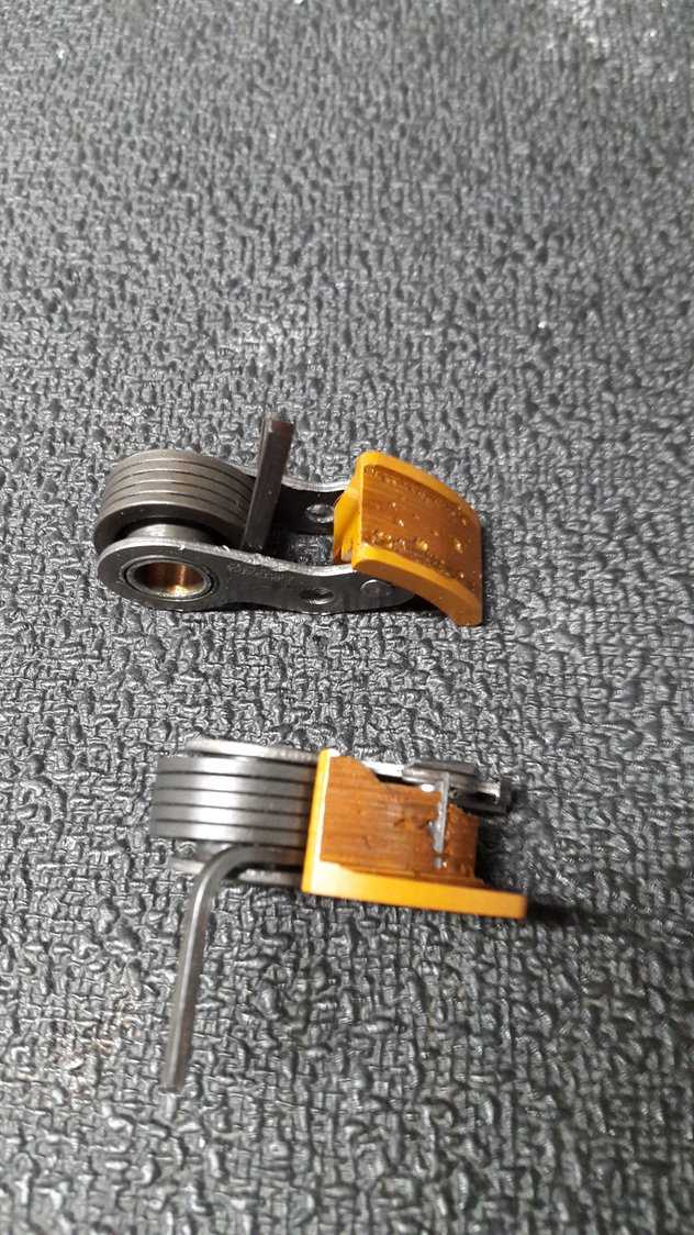

THIS is for anyone who wants to "inspect" spring tensioners. The one on the outside "looked great" according to the owner and I urged him not to ask me to put cam cover back on. When I pulled the cam plate I found the secondary tensioner had failed. I don't remember the miles but it was low enough that even I was shocked at the condition of the secondary. I just won't open the cam cover of a spring tensioner engine and not change the shoes for Cycos.

Joe, you have a late model twin cam with the hydraulic tensioners so I wouldn't change them, they are not a problem. Maybe 75k check them. If your just looking to swap out the cams, even then I would stick with the chain drive, its cheaper, less hassle and has proven to be reliable. Not too difficult. I have done more than a few with no complications.
