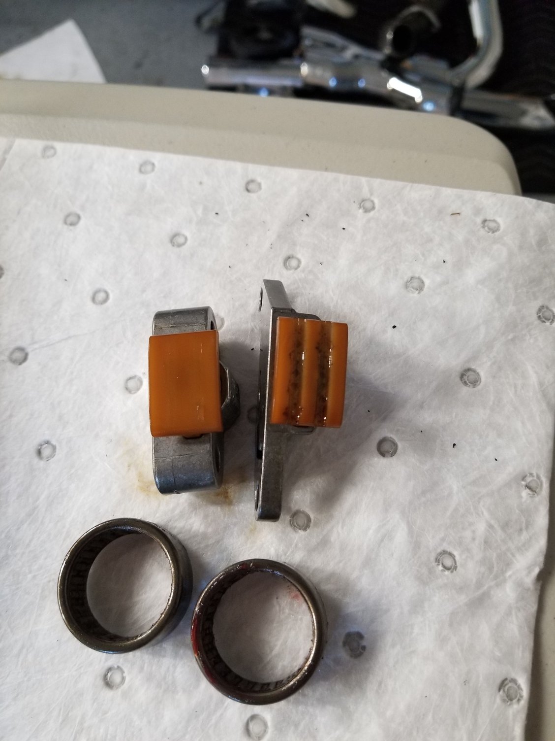

Just an F.Y.I. I replaced these cam tensioner shoes in a friends 2014 FLHTK. The bike had 47k on it. The shoe with the most wear was on the outside. I definitely wouldn't wait more than 50k before checking them.

What has the OP found since his last discovery?
Those needle bearings should have been accounted for when disaasembled.
Did you find the bits of the tension shoe inner and outer ?
The Swap section will offer some tools to remove the cam bearings and re-install them.
The other days there was a kit in their for reasonable $$ being used and all.
Pictures will also help offer opinions on what else you may have to replace .
Rob

Update here. Got the whole thing apart. One of the needle bearings had broken and the cam that was in that was badly worn. I flushed out the system. I got the fueling hydraulic tensioner kit and replaced it along with new cams, and the new oil pump.
I actually got the bike to start and run, better than before but not perfect. It was rough and stalled out at idle. Had some oil leaking from the air filter, figured I out in too much oil, so I drained some out. Seemed to be smoother.
Then the bike wouldn't crank over. I charged the battery up. Then I got the clicking noise. Replaced the starter relay, still clicking. I took the cover off the solenoid and manually depressed the plunger. One click, tried to crank, then dead. Now I don't get the clicking. I don't get anything. No cranking, no clicking, nothing.
does this mean my starter is dead? Is it a solenoid problem? Have I blown some hidden fuse?

Does the motor turn over by hand without the plugs in? If it does pull the primary cover and see what the starter jackshaft is doing. I woould at least scope the cylinders and look for damage. Running the thing with no oil may have killed the top end, im really surprised you didnt pull the heads and check it out.
