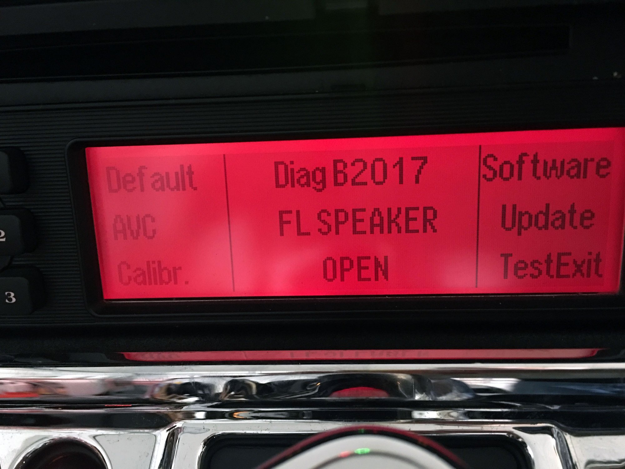

What does the error code B2017 mean? Had the same code show up.

I had the same issue (code B2017) with the head unit on an Ultra I used to own. I got lucky and found a used head unit on Craigslist for only $250.
Next time you remove the outer fairing, make sure the speaker wires are clean and tight. Also, disconnect the wiring connectors on the head unit and spray with electrical contact cleaner (sold at home centers and auto parts stores). Spray the antenna input, too.
Search 'code B2017' on the forum. There are several threads on the topic. Most folks repair the head unit or replace it. Post #9 from Iron Cross in this thread is very telling: https://www.hdforums.com/forum/touri...aker-open.html
