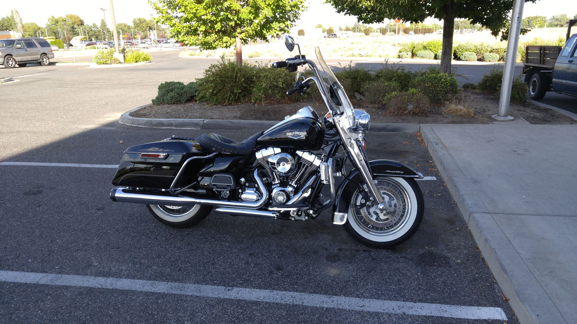

I had a 14 Road King, essentially the same. Pipes - including headpipes, aircleaner and a tune with a powervision made it run as cool as a cucumber and totally woke the bike up. Amazing gains can be made with a good aftermarket stage 1. The warranty shouldnt be affected at all since the strict warranty bs only applies to 17s and newer.
