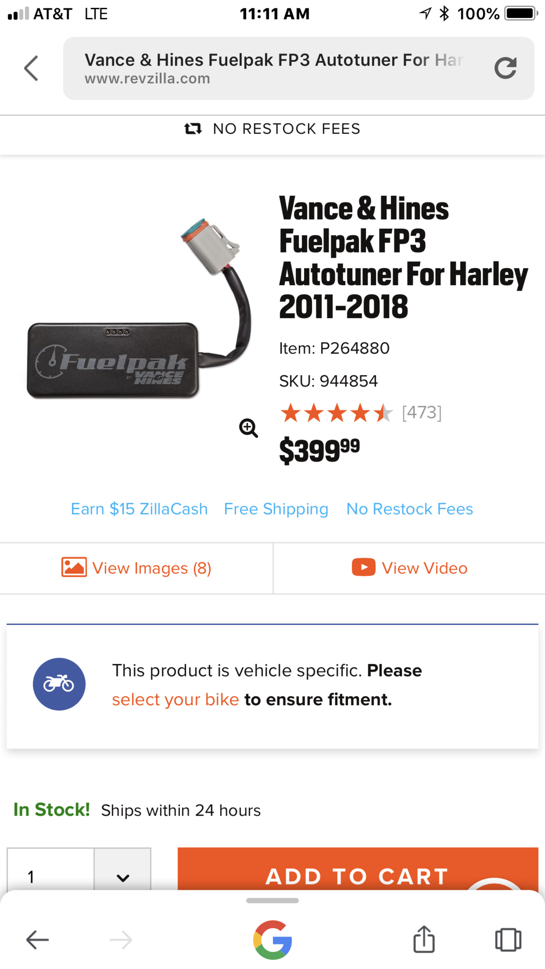

FP3 is what I use. Works great. No complaints. Uses smart phone for interface. Fuel Moto sells them as well. I have one on my 2011 Ultra Limited. Love it.
This thing
