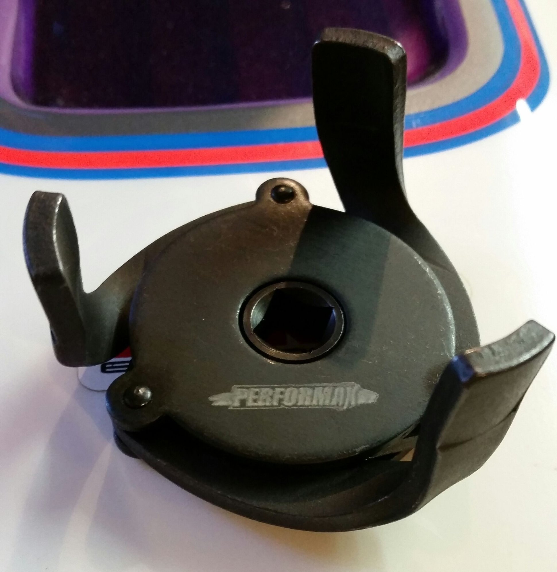

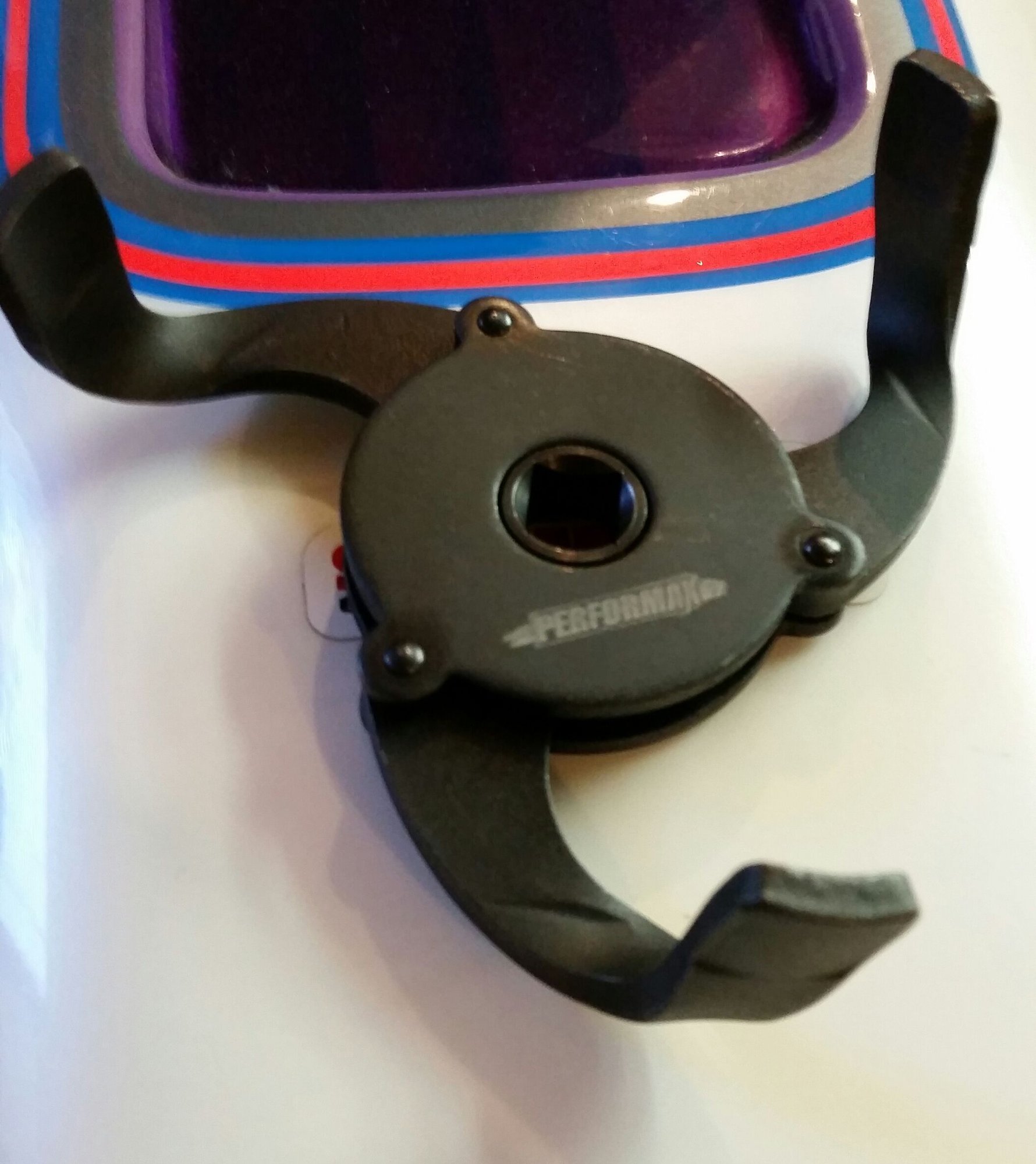

Pretty much the only filter wrench I use anymore. Never slips, misses the crank sensor. Happened to find it in the bargain bin at Menards, only $2. Figured I'd throw it away if it didn't work, but now I could throw all those other ones away and never miss 'em!
