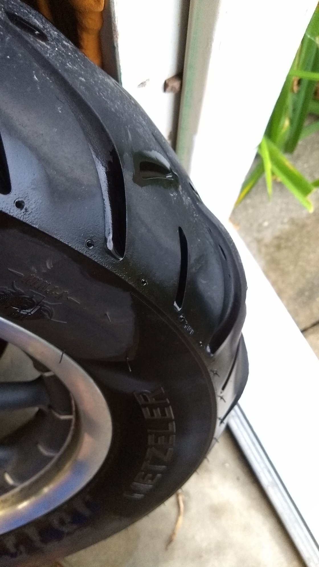

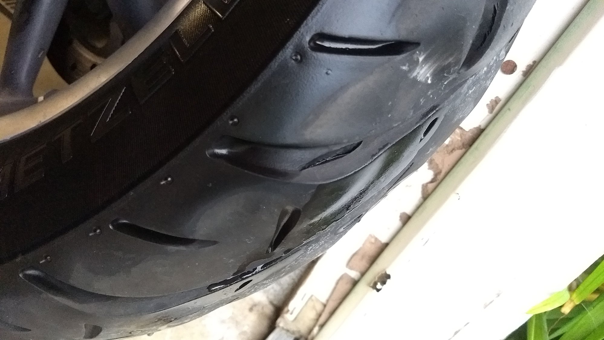

Finally some time off work and good weather to ride and I find this goiter on my 6k mile Metzeler 888. Ugh. Going Michelin Commander 2 this time.

That's nasty - in your top photo it looks as if there is a second one lower down.

... and a good thing you caught it before you got out and had a problem

Move the wheel weights opposite the bubbles and ride ON!
THAT ^ was a JOKE. Seriously, I've seen MC tires like that before; they were mounted in the wrong direction and braking pulled the tread splice apart. My guess is that's a made in Brazil Metzeler.

Yep, Brazilian tire. Friends of mine has one on an 09 and it lived it's life but it cupped pretty badly.
I kept a reasonably close eye on pressure and have balance beads in it which might be why I didn't notice any awful vibration.
Calling shops tomorrow to find a tire or I'll just order one. Then I'm calling Metzeler to see if they'll do anything about it.
