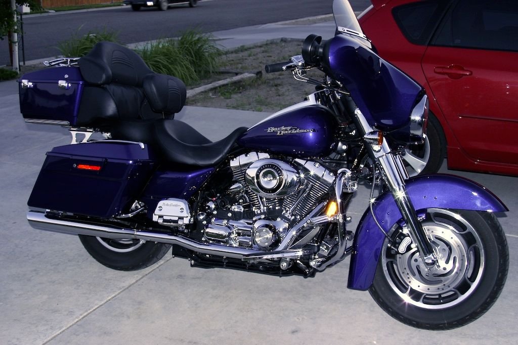

My 2007 With 16"

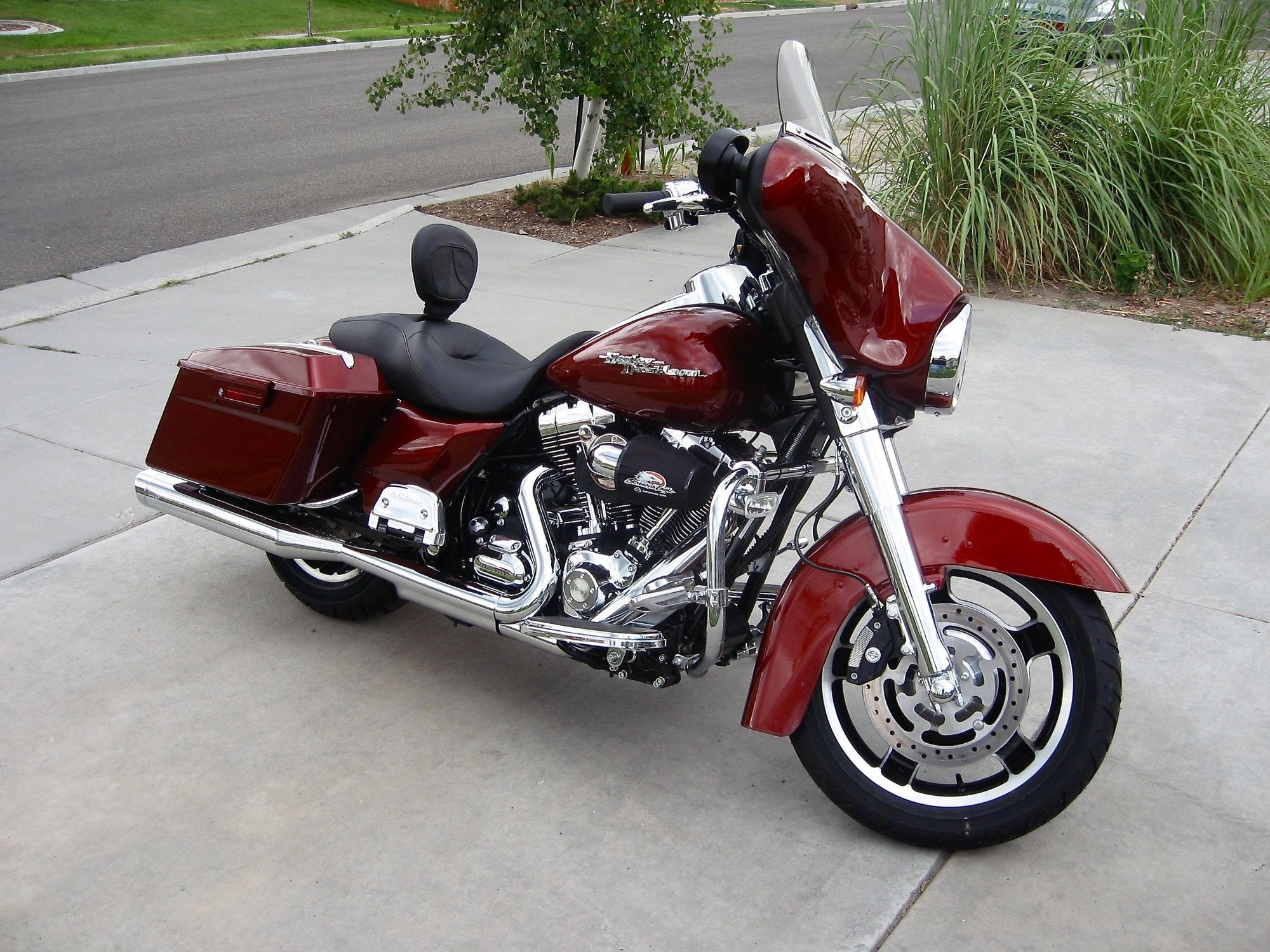

My 2009 With original 17"

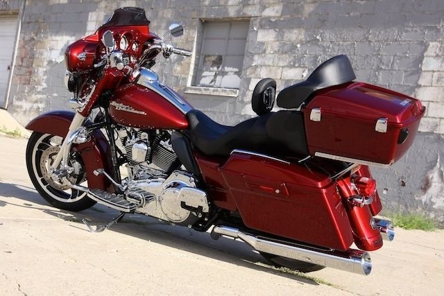

2009 with 18"

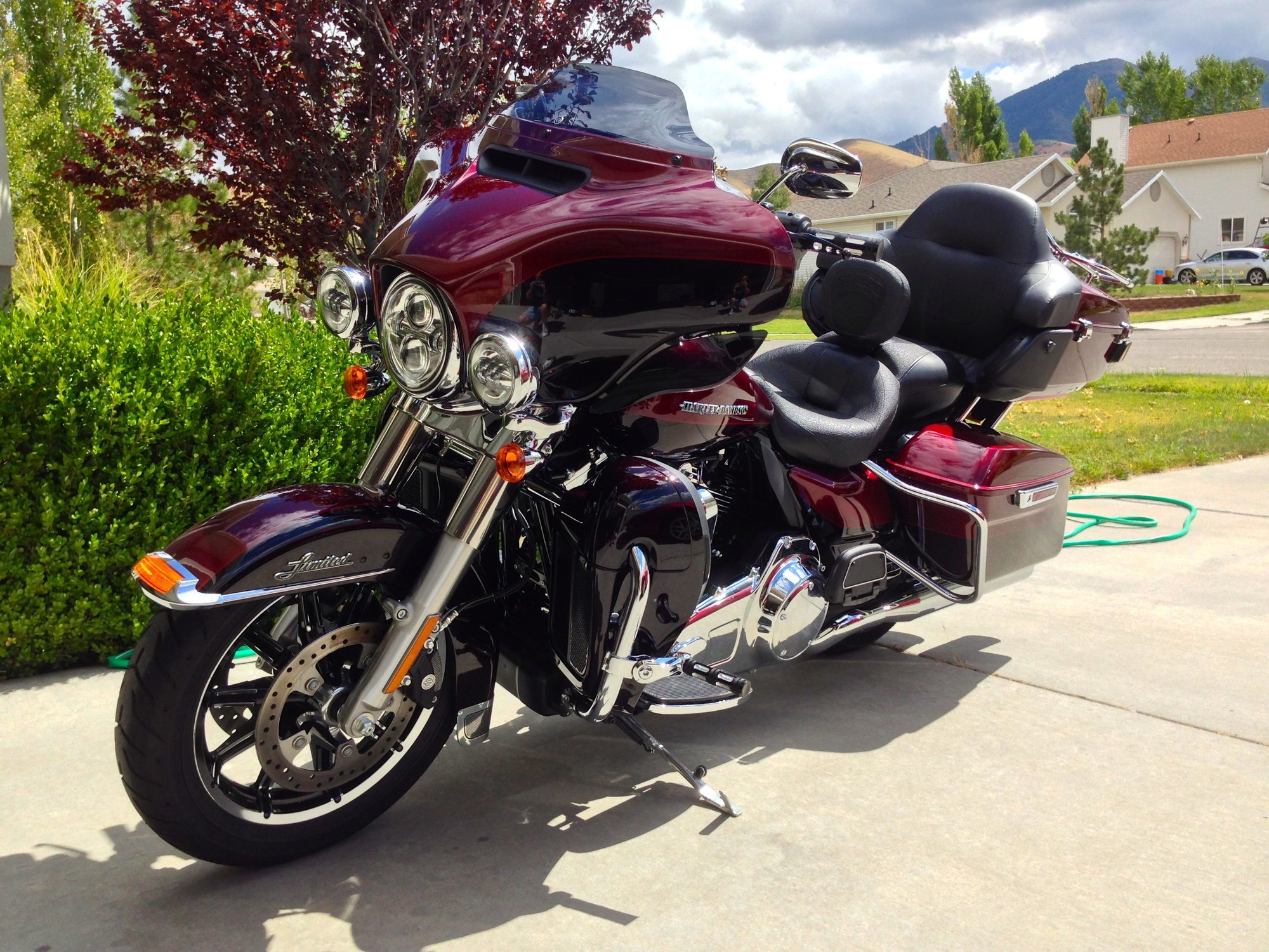

2014 Limited original 17"

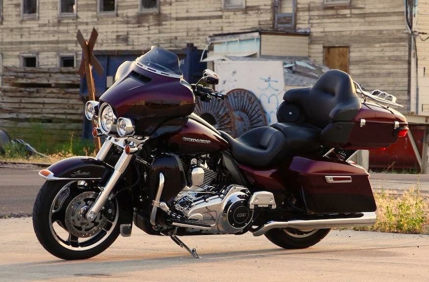

2014 Limited with 18" SG wheel

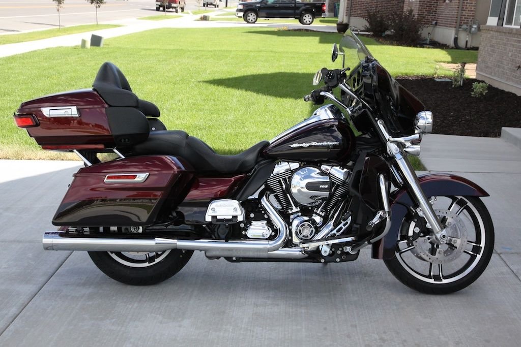

2014 Limited with 19" Enforcer
