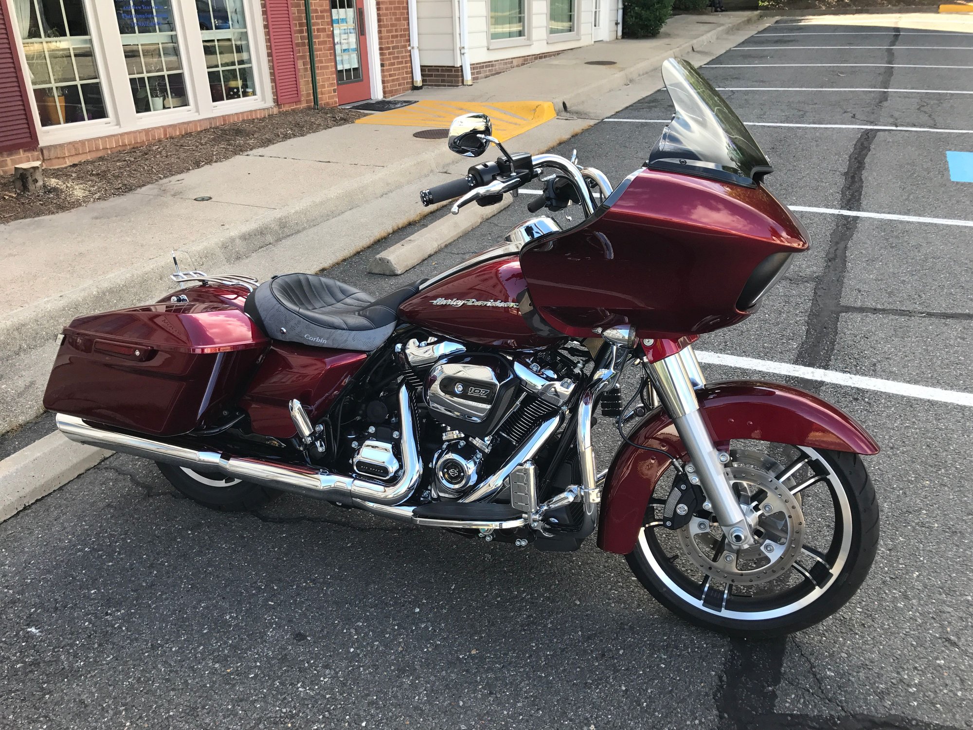

The problem with seats - all motorcycle seats - is they are 1) designed to be built inexpensively as OEM and 2) designed to be soft so they feel good in the showroom and that 15 minute test ride. Doesn't matter what brand the bike is, either. So here's what you want to do:
Take a look at how the seat is made that you are considering to use as the replacement. Plastic-flexi-pan or metal? Metal is stiffer - and you want stiffer. How is the seat cover attached? Staples or Riveted on? Rivets are better. Most HD seats, even their "upgraded" ones, use that plastic pan and staples. How soft is the seat? You really want a very supportive seat, which is going to translate as firm when you try it out. You might think too firm, however as you put down miles that firmness is what is going to keep you from squirming around. Give the new seat some time for you to get used to it. When you look at a seat, especially if it has an incorporated backrest to go with it, push down hard around that insert for the backrest and see if you feel any edges or resistance. If you do - pass on that seat, because that will create a hot spot when you are riding (Mustang seats are notorious for this).
I ride with Corbins on my Harleys - Sargent seats on my BMW's. For me, they flat out work and do the job. Neither is inexpensive.

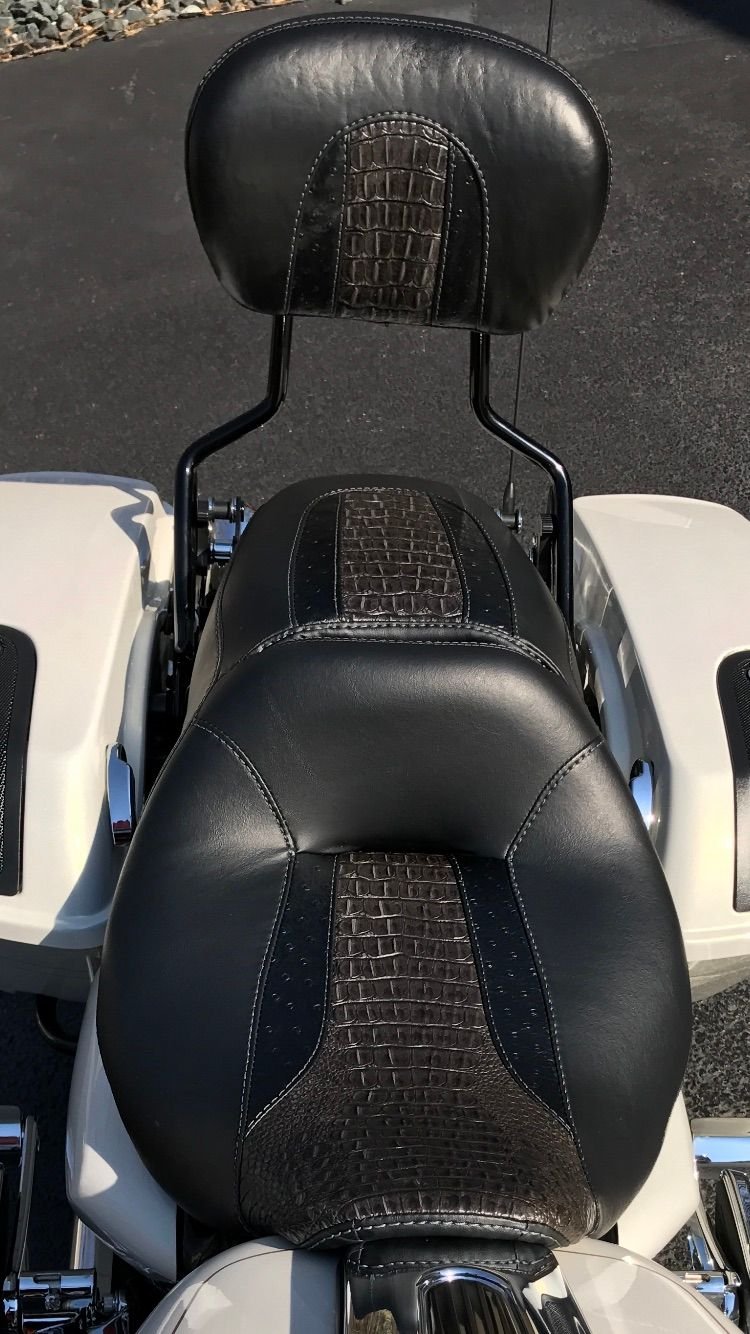

Ultimate solo with back rest...Very comfy and well built....18 Road Glide

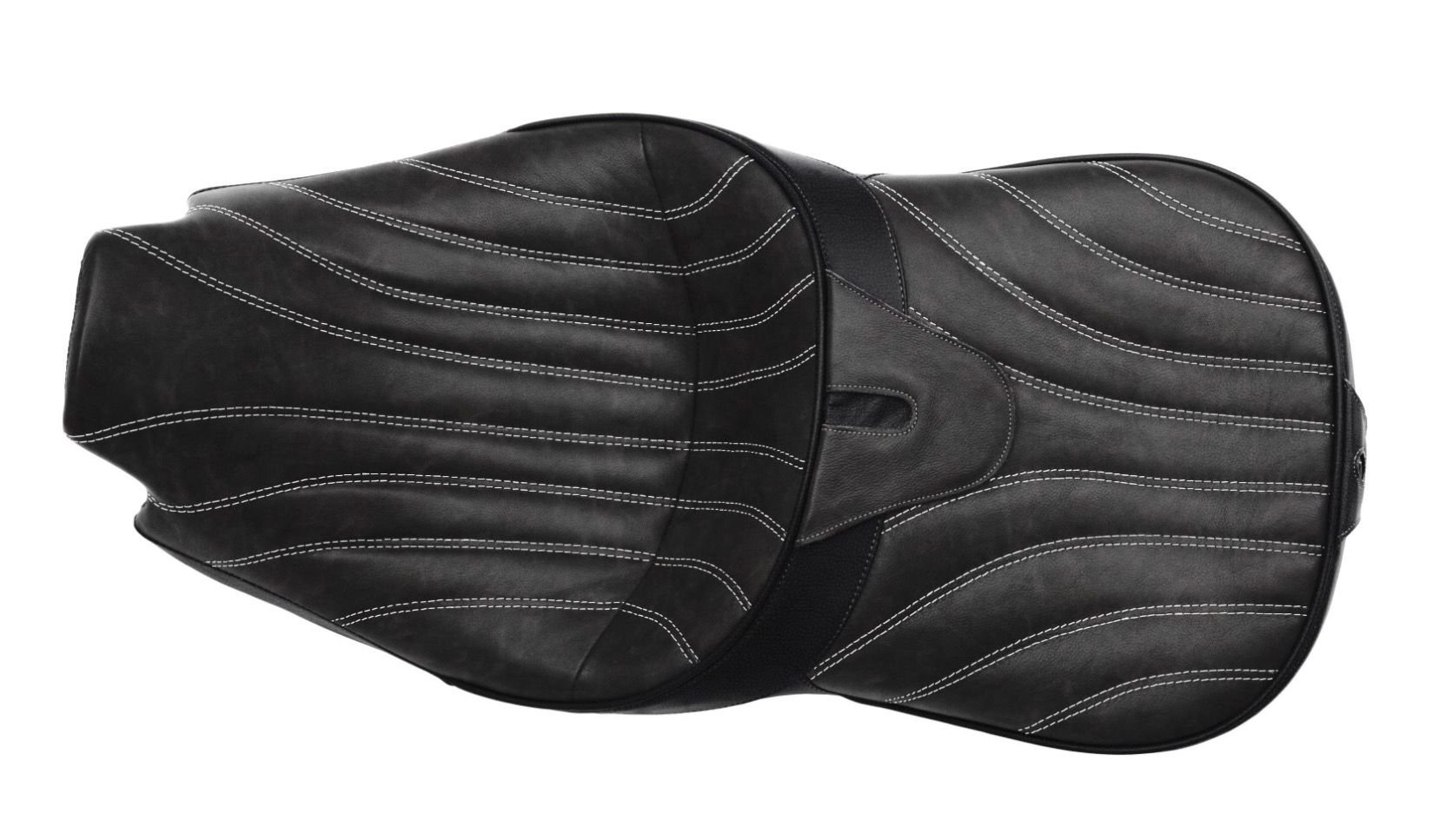

http://corbin.com/harley/baggers/hdflh14dte.shtml
I've tried several seats, including some of the ones mentioned above. The Corbin beats all, hands down, for me. Too, you can call or use their site to customize materials, colors, etc.
I had my stock seat modified by Mean City Cycles, then went to a Mustang. This spring I did what I should have to start with, bought a Corbin. My wife and I both love it.
