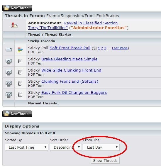

Not sure if my post in the brake technical section was deleted or if I suck at searching..
It wasn't deleted, you need to change the "Display Options" to something other than "Last Day" (and click "Show Threads") and do that (if applicable) every time you come to that section
