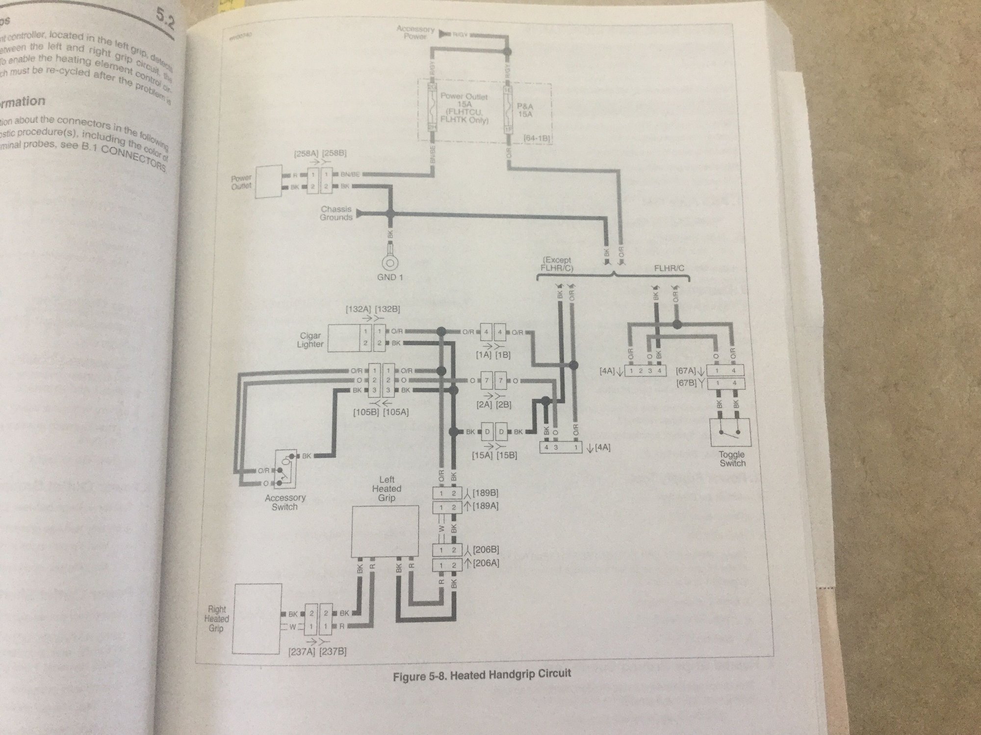

If the VR doesn't cure the Heated grips disconnect connector 189 and check continuity between the wires going to the left grip. I don't have a 2013 Elect. manual but 2010 says the grips on high draw about 3 amps. Measuring ohms on the wires going to left grips you should see 12/3=4ohm on max open on off.
