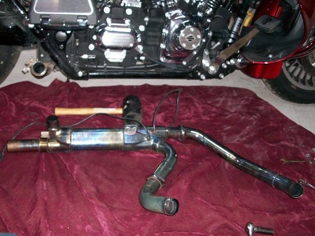

I installed my 2/1/2 and a set of Street Cannons tonight, use their Gaskets and transfer the clips and flanges and Clamps if you bought new heat shields.
I changed from Chrome to Black with HD Heat Shields, a pic of my son take it for the maiden voyage :-)
