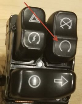

Originally Posted by Rocket67
***EDIT**** I see a fuse was blown, still...this is the issue for some folks. Used to happen a lot when we went mudding on our ATV's. ***EDIT***
Make sure this button is "ON".
I don’t know how many times I’ve flipped that switch on accident while cleaning and panic when it won’t start.
